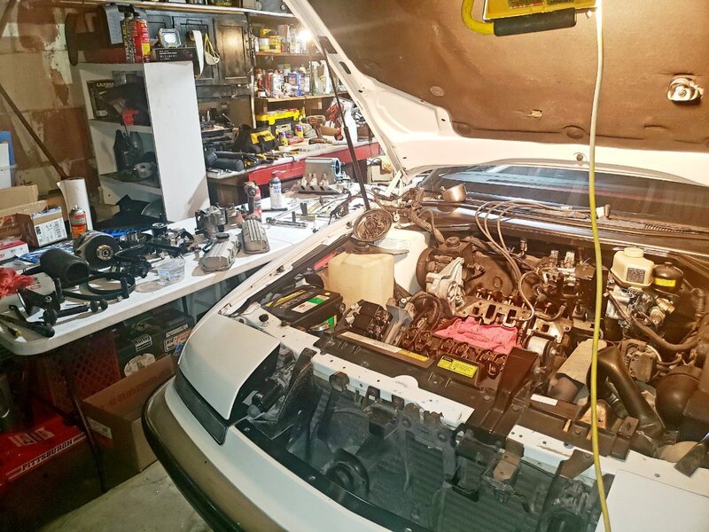

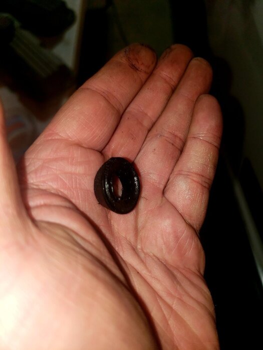

  1. Update: found the end of the grommet in the rear head. It was hard as a rock. Not sure I'd be comfortable with that going through my valves...lol The other discovery was my intake and throttle body was gummed up with black thick oil residue. So, unless I got a bad set of rings somewhere, im pretty sure the PCV had been an issue for quite some time... and this all should solve the rough idle/misfire situation. Im gonna reassemble the top end tomorrow and get the timing chain done by Wednesday. I did find a couple coppers showing on some wiring. So I want to run-through and rewrap the harness also. I'll update with the running status in a few days.

  4. Progress👍 As well as the PCV, a major contributor to the grunge inside the intake manifold is the EGR and the remnants of combustion released by open intake valves upon engine shutdown. There are always one or more partially open when stopped and the hot vapors rise.
