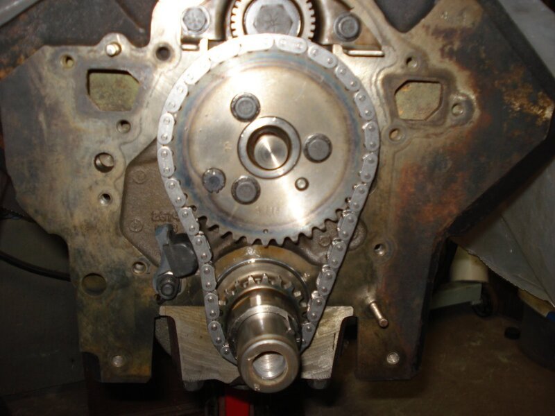

  1. Cam sprocket and balance shaft gear is retained by three small bolts. It isn't an issue to hold the cam still while torquing. Use blue Loctitie on the bolts. It will be nigh on impossible to spin the engine over from a cam bolt. Use the crank bolt. Without the chain connecting the cam to the crank, the cam and balance shaft are free to rotate on their own, but the tension from the lifters and valve springs will tend to keep it in place. Balance shaft at top, balance shaft gear installed on camshaft in middle, crankshaft at bottom. , c

  3. This is a pic from my teardown of the 1995 s/c engine, the last of the true Series I engines. The cam uses a large single center bolt as a retainer and no cam button. I imagine Series 2 are similar.
  4. That might apply to the old 3.8 that didn't have a balance shaft. Your 3800 should have a cam button in the center and three small bolts hoilding the cam sprocket on. Be sure to install the cam position sensor magnet from the rear of the sprocket. 2seater gave you good advice. He is the go-to guy on 3800 engines.
