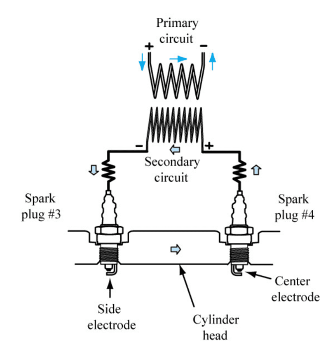

  2. One thing I forgot to mention about the inexpensive spark checkers: If you have one or more that appear to indicate irregular spark, switch it with another and observe if the problem child follows the spark tester. The way the ignition system works, if you lose one spark plug, the other one of the pair is likely compromised as well.
