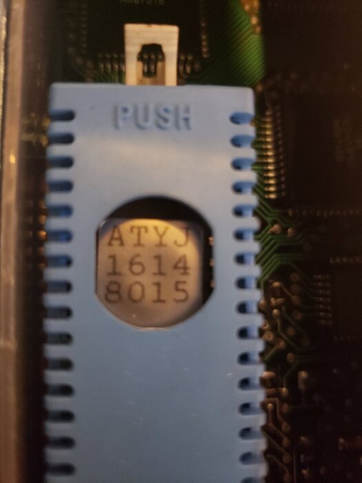

  1. This is were an ignition scope is nice but if ECM dies, there is a backup system. What PROM did you put in the new ECM ?

  3. I just did the cam and crank sensors... and the harmonic balancer... no change. I will be swapping out the ICM as well. It just this new issue after replacing the ECM thats got me stuck. @2seater gonna switch with old ECM again... its just that I reinstalled it after it started up fine. Instrument cluster has had no obvious issues. @Padgett I put the PROM from the one I pulled in the new one.

  5. I would bet the instrument cluster has stuff not working either. If you have no ECM data the chip is not communicating properly. R&R the Prom and see if it is a fluke otherwise, try the old ECM again and see if that goes away.
