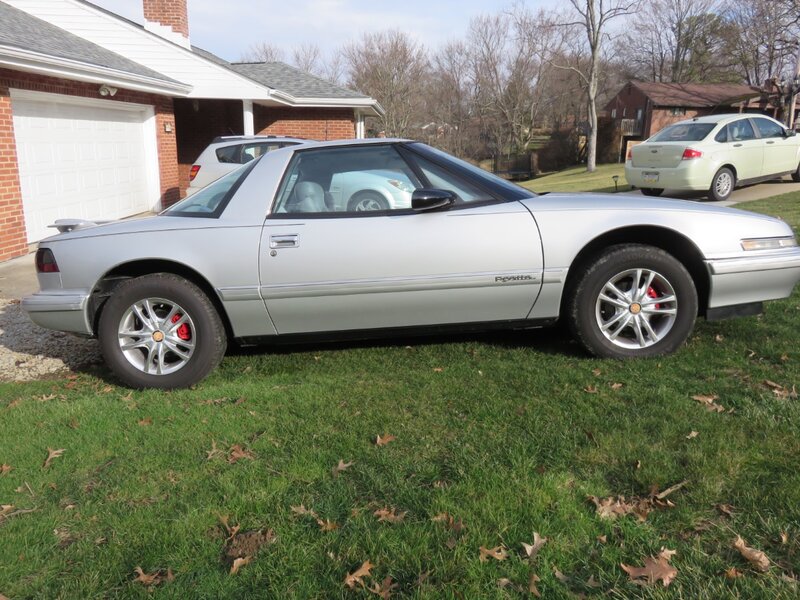

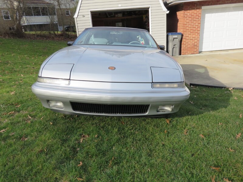

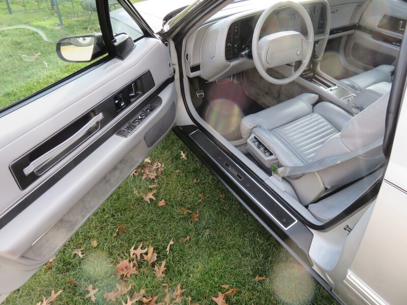

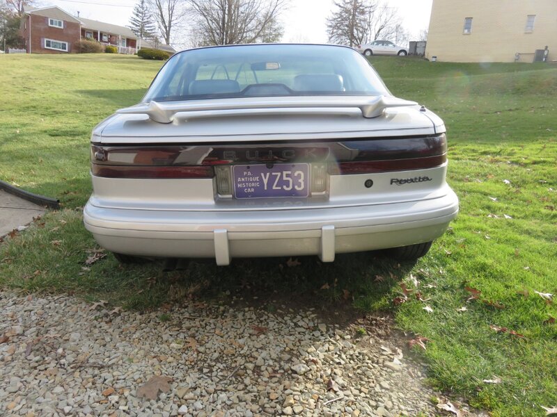

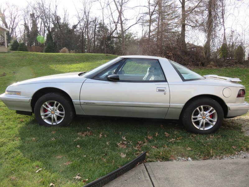

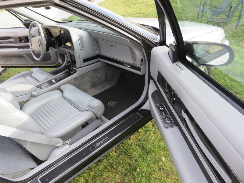

  2. Selling my 1990 Buick Reatta to make room for my 1990 Reatta convertible. 102,000 pampered miles. Runs and drives great. Pgh. Pa. area. $8500. Aftermarket radio with backup camera. Original radio included.
