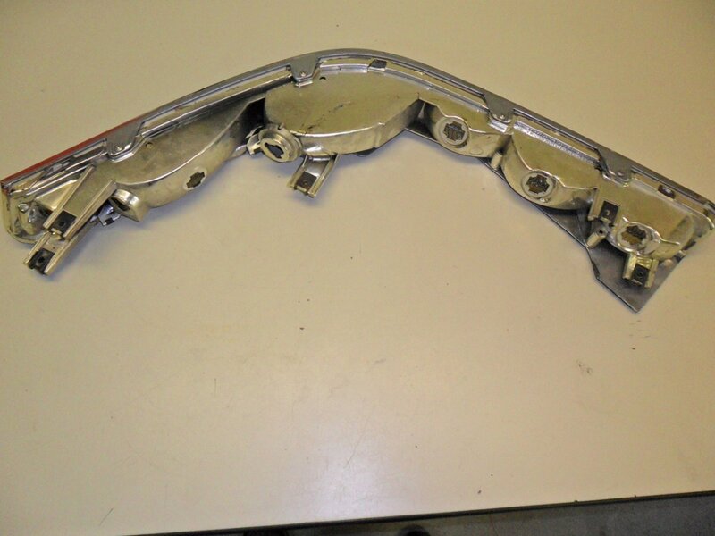

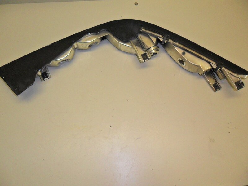

  4. The photos below might help you with visualizing what you are feeling when you stick your hand up in there. I think the photos are of the passenger side light but I'm not certain. I think oil on your hands is the problem with touching the bulb. Wearing bulbs gloves is a good idea.
