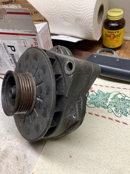

  1. That’s not unusual. This is a pic of my 140a from a junkyard engine. The air is pulled in the back of the alternator over the rectifier and brushes and exits through the fan. It probably increases efficiency of the fan by reducing turbulence. As long as the belt lines up, it is all good
