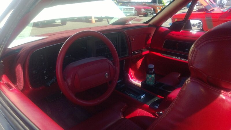

  3. If you go on their website, the '88-'91 Reatta takes size "AX" (from their steering wheel size chart). The website is: Leather Steering Wheel Covers Manufacturer and Distributor (wheelskins.com). For the one you want to look into click on "Original One-Color $65.95".
  4. You just have to take your time stitching. I took pics and studied the stitching of the original before stripping off the old.
  5. I used Wheelskins' Flame Red wheel wrap for my '91. In order to have the resulting wheel thickness remain the same, I removed the original wrap. I did not put the Wheelskins wrap over the original.
