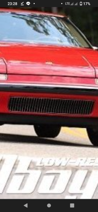

  2. Yeah, I zoomed in on the photo before I posted. That is the reason I said, "If you use some imagination you might think the rear tire is about to lift ". I just like to post photos of my car. 🙂

  11. @RonnieI think the shadows are playing tricks. If you zoom way in, it looks like that tire is still on the ground.
