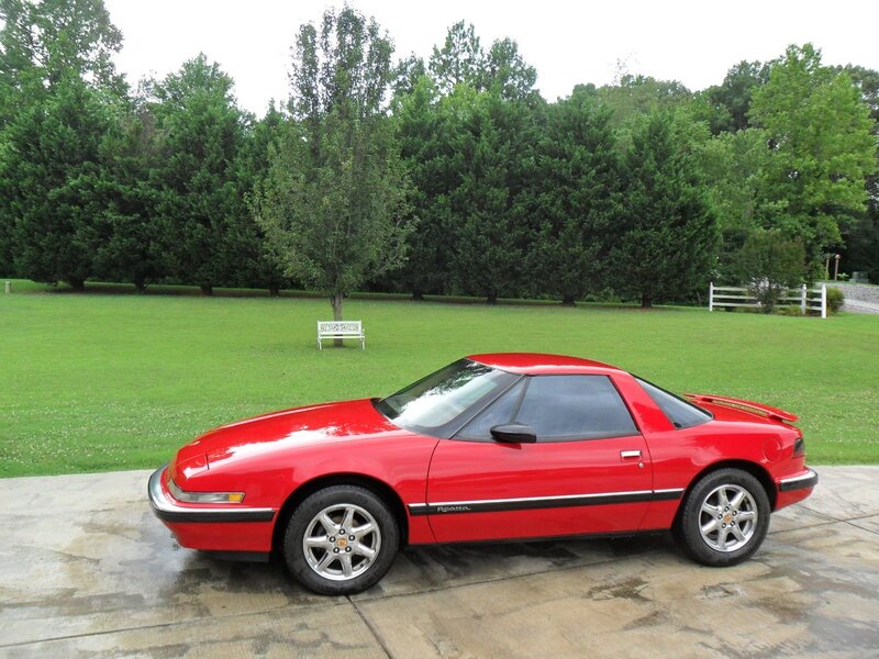

  1. Regarding the wrap around effect of the black molding, I can see the aluminum stripe which is on top of the molding as providing this effect. As to the black molding itself, perhaps it is intended to give the impression that the Reatta sits low to the ground and provides a sleeker profile..............
  2. Standard shock, no, but maybe a standard strut. There are universal struts out there like the konis that maybe could be retrofit in a similar way.
  3. I think it does that to. Don't know if GM intentionally did it for that reason. I think the pinstripe does the same thing. I removed the pinstripe on mine and I think it makes it look a little fatter. Gives it more of a '68 Camaro look.
