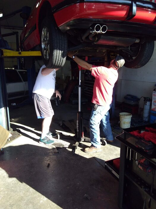

  2. My pump went out several months ago. I didn't have anyone to help me either. I don't know of any easy shortcuts on dropping the tank or cutting holes to access the pump. I took mine to a garage that had a lift and a big jack, which made easy work of it. In and out in about 2 hours. I'm a pretty good mechanic but some things I don't like doing anymore now that I'm older. Also don't want to take chances with gasoline in my garage if I don't have to. Spend a few bucks and get it done right the first time. Pump is only about $50-60 on Amazon. Buy a Delphi or ACDelco pump. Don't go the cheap route on the pump. .
