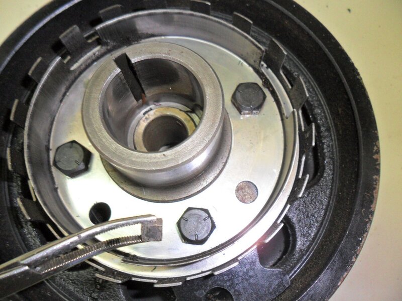

  1. Is cheap enough to just keep one around. As can see in the last picture I just eyeball it into the center. Have seen the center or two magnets broken before, not uncommon.

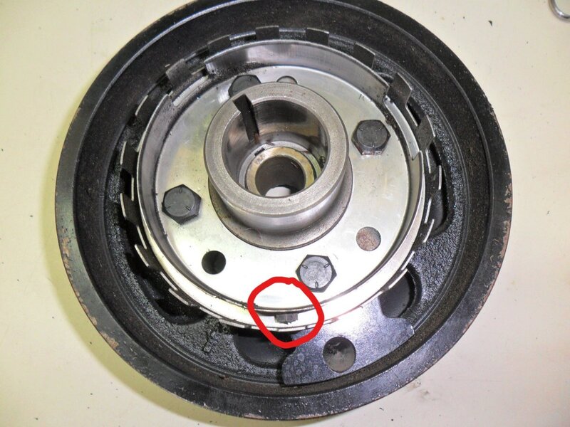

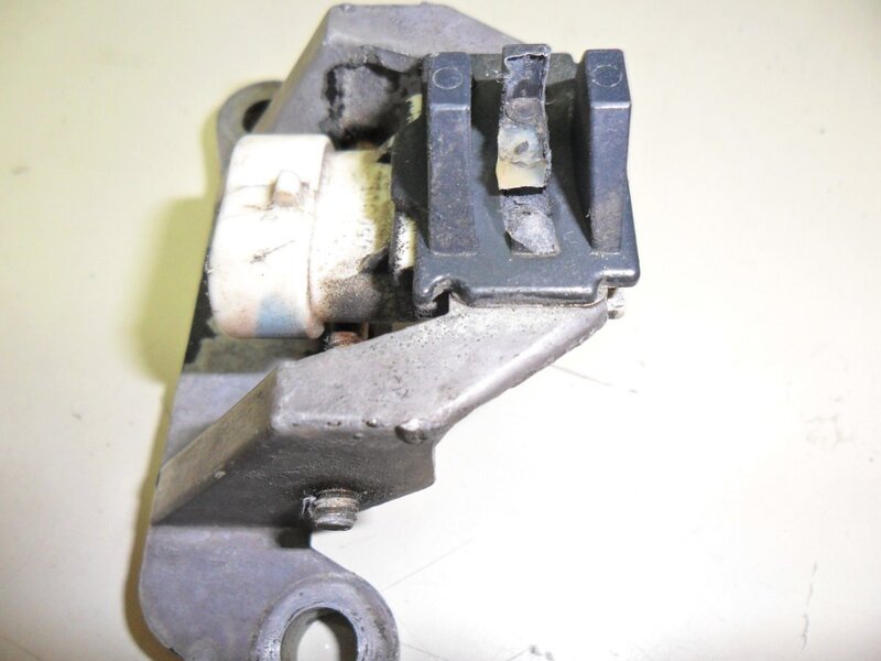

  4. I think mine was probably the original CPS. I do believe the plastic that incases the magnet in that center piece was old and brittle and it just finally disintegrated and the magnet fell out. As you can see in one of my pervious photos, the magnet itself wasn't even broke. It just fell out and was stuck to the side of the metal shutter ring. I couldn't find any signs that would lead me to believe the broken plastic was caused by something hitting the sensor. I was lucky that the magnet didn't cause any damage. I changed the harmonic balancer shortly after I got the car in 2007 because I had heard so much about it going bad. I didn't change the CPS at that time. If I had it to do over I would have changed the CPS at the same time as preventive maintenance.
  5. This was my first time replacing the CPS on a Reatta. It's not really too hard to do. Getting tips and guidance from the guys here on the forum so you know what to expect makes it a lot easier.
