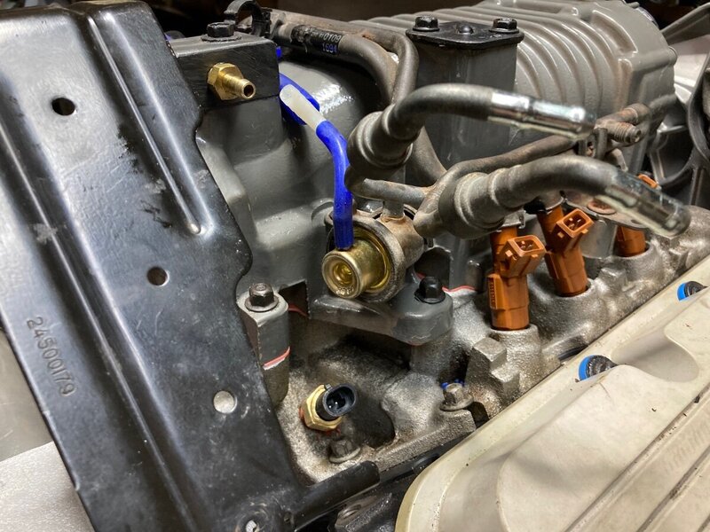

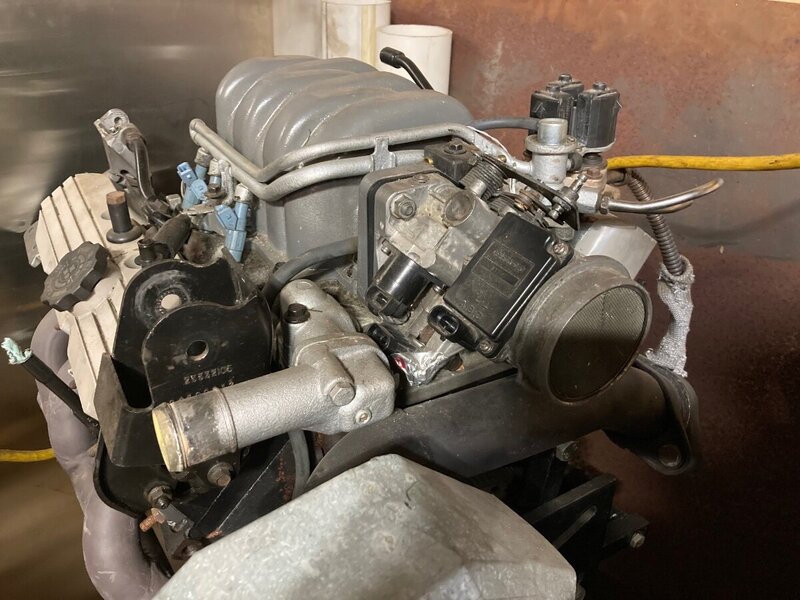

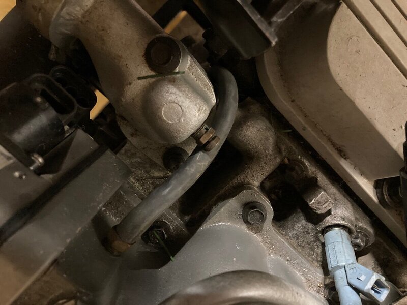

  6. This is a rear view and the regulator lays on its side, small blue tube connected to it. The regulator itself is a little cartridge retained with a snap ring. The cylindrical housing is welded into the fuel rail. There are two views of the TPI manifold on my half turbo install. The fuel pressure regulator is the same type but it sits vertically visible in the upper right of photo. Also visible is a pipe plug in the top of the horizontal thermostat elbow and the other photo shows a bleeder in the back side of a similar elbow. It seems this style elbow, which just uses a conventional flat paper gasket, has a bleeder port somewhere as standard?
