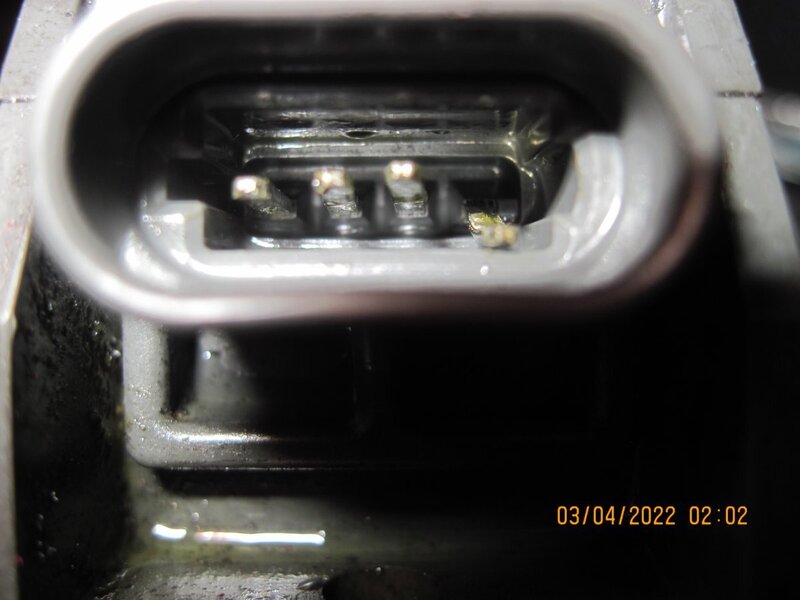

  1. When removing you may need to jumper some pins.
  2. Bend the pin back. If it does not fall off it may be fine.

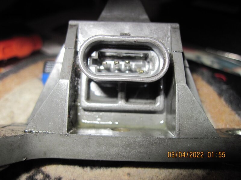

  3. Thank You, ThankYou, Thank You, Ronnie & 2seater. I found it, Now mind you I put this on in about 2010 and it just started to bug me about three years ago. Take a look at this. Can you see it? Now do you think I should replace it or bend the pin back and use it?
  4. Ronnie, I thought I replied to you e-mail but It didn't send I guess. Anyway, You are correct and I apologize. I have been confused about this problem for quite a while so I was not thinking when I sent that reply. That is one area that I had not considered. That will be the next thing to check. Hopefully that is the problem. Thanks for all the replies. I will get right on it.
  5. I think you are thinking about the Camshaft Position Sensor. It has a magnet that triggers it. The Crankshaft Position Sensor has no magnet.. It is the sensor mounted on the engine block behind the harmonic balancer.
