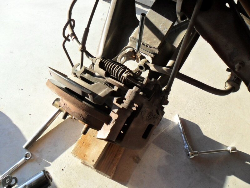

  6. Although the rear suspension has a component that looks like a shock, it is actually a strut in the fact that it is designed to play an important role in keeping the rear wheel in alignment. It is basically what controls the camber of the rear wheel as it goes up and down. When you remove the strut, the knuckle will just flop over as shown in the photo below. I have the wooden blocks under the knuckle to prevent it from pivoting out too far out and putting a strain on the cables and hose attached to it. The strut has a larger diameter rod than a regular shock that is rigid enough to keep the knuckle in alignment when the wheel is on the ground. I don't know if it would be as simple as just fabricating a new shock mount to accept a gas shock. I think a gas shock would have a smaller diameter rod that might flex or bend when hitting a large pot hole or bump in the road. It's not too hard to bottom out the suspension on a Reatta in those situations resulting in even more stress on the rod. It will be interesting to see what you come up with.
