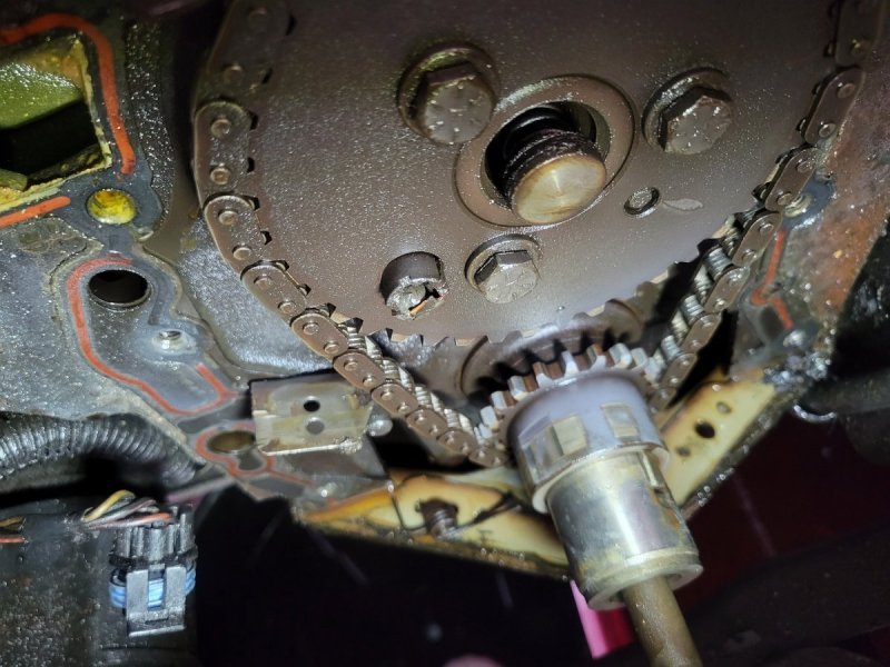

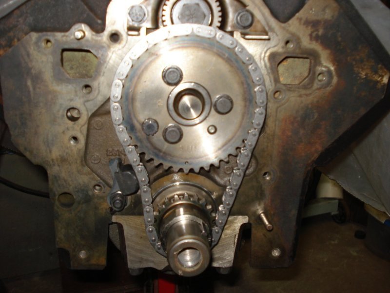

  7. Thank you. That is the original style chain dampener and the chain appears to be the correct Morse brand (it is stamped on some of the side plates). How many miles on the engine? This is what the original should have looked like:
  8. You can see what's left of the tensioner. The spring is laying on top of the oil pan.

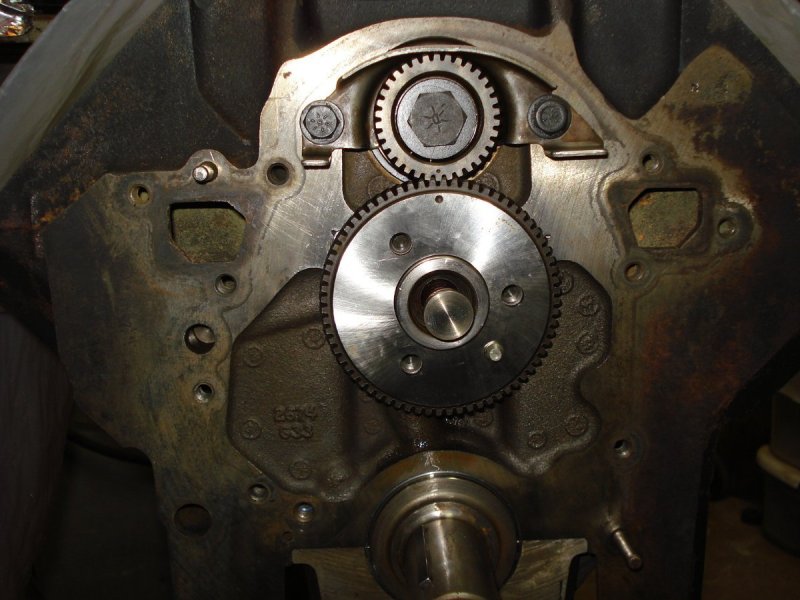

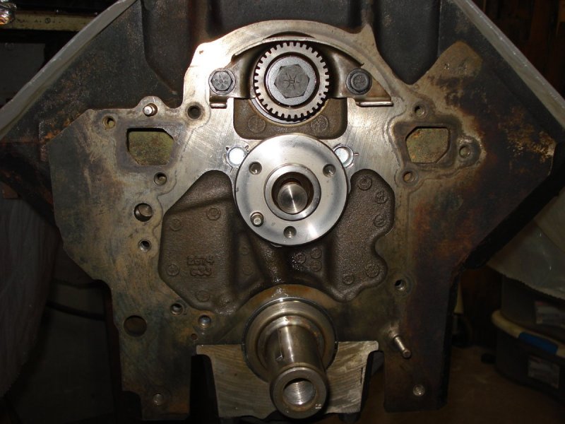

  10. Yes, you are missing the gear behind the cam sprocket. It lines up dot to dot just like a cam to crank setup. I have enclosed two photos of the bare cam and with the balance shaft gear in place. The biggest issue I have with this is it is unlikely the cam sprocket and crank sprocket line up properly. A straight edge across the two should be flush with each other. The whole reason the 3800 has such a skinny timing chain is because the balance shaft drive was added which took up real estate for the chain and sprocket. I see yours is an '88 which has a slightly different thickness (thicker) drive flange that bears up against the block where the later cams have a little thinner flange with a spacer shim washer behind it. They are interchangeable but the early cam must be installed bare and the later, 89 and 90, must have the shim washer.
