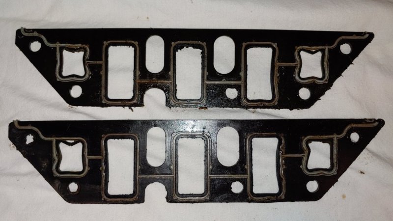

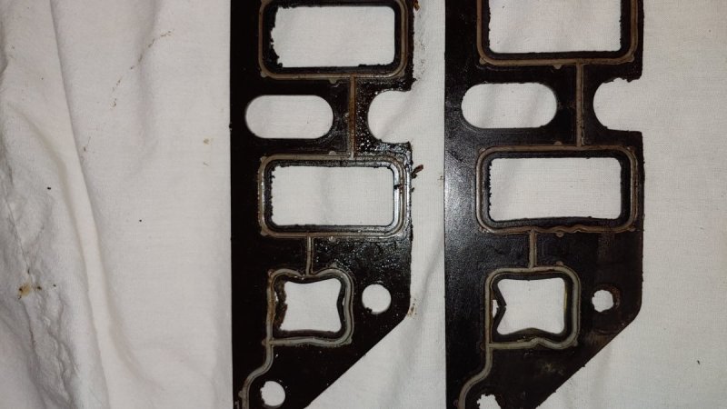

  2. A month or so ago, I found a little coolant puddle on my garage floor. Decided to look into it now that the cold weather season has set in. After pressurizing the cooling system with a radiator pump tester, I saw a slow drip off the bottom of the engine. Followed the trail of coolant to the top of the engine. It was a slowly oozing up between the intake and the head right below the EGR valve . So I pulled the intake yesterday and this is what the gaskets look like. Kinda worse than I was expecting. Surprised it was that kinked and distorted around the ports. Now I am waiting for all the misc gaskets and hoses to put it all back together.
  3. Check around the water ports, particularly the corner that was leaking. The intake manifold surface will likely be pitted or eroded around that port from galvanic corrosion. If it is and it looks fairly deep, I have had good results filling the erosion with epoxy such as JB Weld and then a flat file to smooth the surface.
