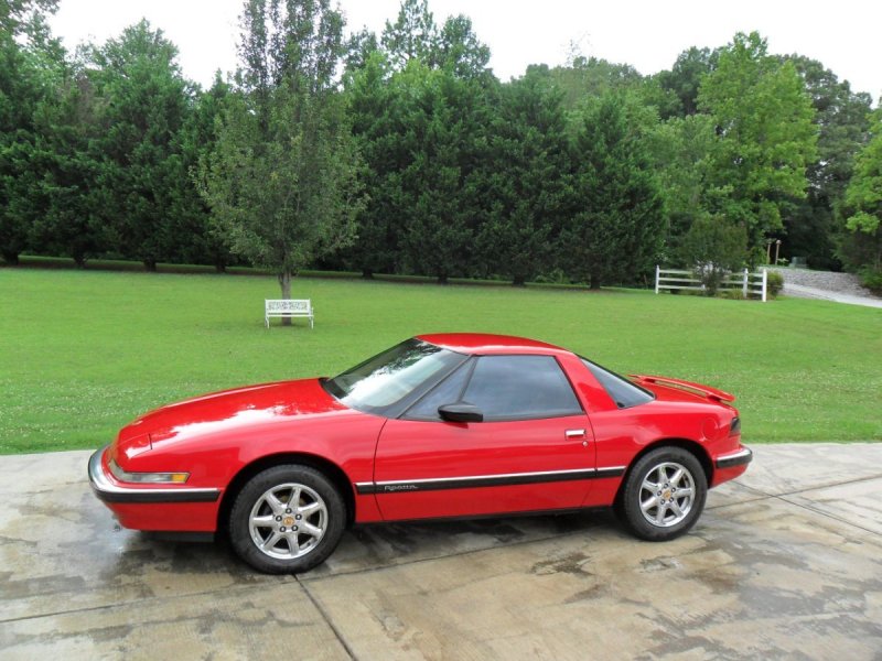

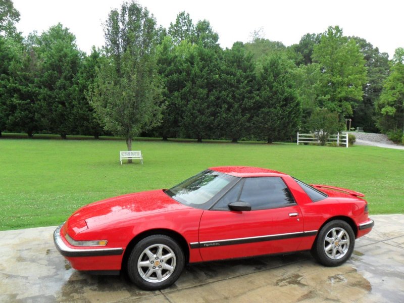

  3. Sometimes when people are trying to sell their Reatta they post photos of it while it's wet to make the paint look shinier. I can't tell much difference in my Reatta between wet and dry in the photos I took this morning after washing and drying it. I think mine looks shinier dry. Completely wet after washing Completely Dry Back in the garage asleep 🙂

  6. Agree - dry is shinier. Major difference between wet and dry is the wetness of the concrete!
