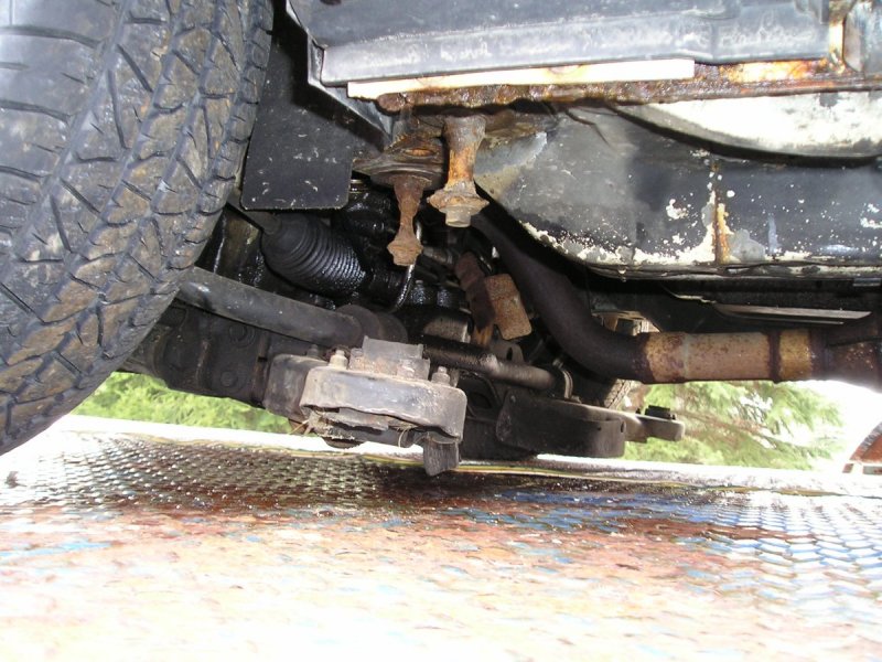

  3. If you are in the rust belt be sure to check the cradle mounts and the control arm torque rods (may not be the correct name for the rod) where they go into the rubber bushings. Either on being rusted out can be a safety issue. The photo below shows what can happen to the cradle bushings although it is on the extreme end of the scale. Hard to say on the price without seeing more photos inside and out. Sounds like you are in the ballpark on price.
