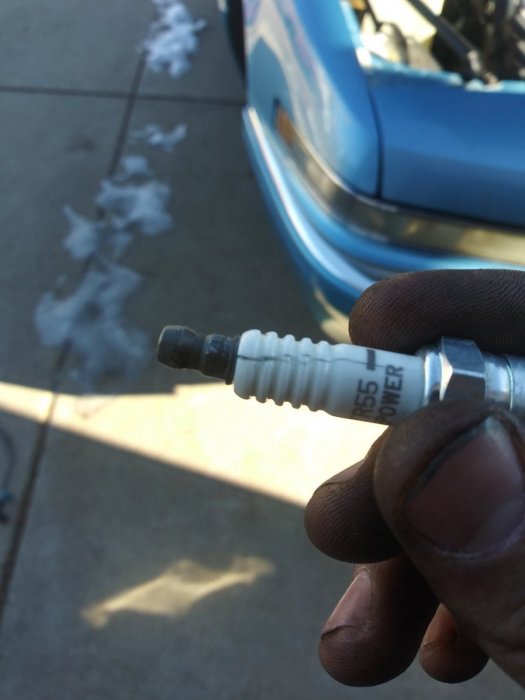

  1. I FOUND THE PROBLEM!!!! I did what ronnie mentioned (can't believe I didn't think of it earlier) which was to pull each wire off until it doesn't make a difference to idle quality. So turns out, as a matter of coincidence, on cylinder 4 I had a bad spark plug wire so I swapped it with another set I bought from a 91. After I swapped the wire it started making a ticking sound. So I pulled the plug and found it was cracked down the insulator. I've never seen that before. I will attach a pic of the plug. On a side note if any one reading all this in the future is swapping over to the Delco ignition set up I HIGHLY recommend buying a spark plug wire set from a 91 reatta. They fit beautifully and make a nice solid connection. Thank you every one for your help! You guys are miracle workers! I learned so much about this car with your guy's help! I will admit my troubleshooting skills have certainly perished from not getting enough sleep due to working night shift and all your guy's help in steering me is greatly appreciated!
  2. Sometimes getting down to basics and using old school troubleshooting pays off. Glad to hear you found the problem!
