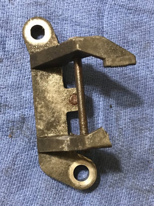

  1. Mounting the new CPS into the old frame/holder revealed a crooked alignment with the balancer teeth.... Well, I removed the balancer again, and there was a crack in the 'ear' of the CPS mount, because it broke off without much provocation.... Thus, I needed to replace it, and in doing so, part of the pin broke as well (doh). I'm of the impression that the pin isn't entirely necessary, if the new frame/holder can be installed in the correct location and secured with the bolts... So I did that, and put the CPS on it.... When mounting the harmomic balancer again, it was not crooked, but it revealed several of the 'teeth' needed to be straightened, which I did... Another cycle of balancer removal and mounting shows that there is no touching of the teeth to the CPS. Unfortunately, I will have to finish the job Thursday, as I have work to do on Tues/Weds... The saga continues....
