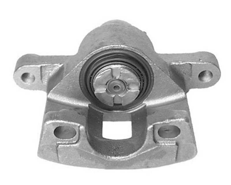

  6. Welcome to the forum! The problem may not be the parking brake but it could be that the piston adjuster screw may need to be screwed back in. There is a self adjusting feature built into the caliper piston that has to be screwed back in to give more room for the pads to slide in. Below is a photo showing what I mean and a photo of the tool needed. I think some other tool might be substituted to screw the piston in. The tool fits into the notches of the piston shown in the first photo.
