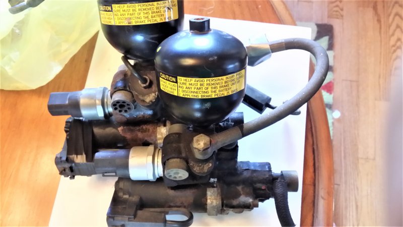

DAVES89 Posted April 14, 2017 Share Posted April 14, 2017 I don't believe the one you have is an '88. the hard line on the top has bleeder screw style bolts. If you replace the entire unit you are good, pump motor not so much. I never knew there was a difference either. However I think you could do a double flare and maybe make it work. Could you take a look at yours [the one in the car and the one you have in your back stock] and offer an opinion? Link to comment Share on other sites More sharing options...
2seater Posted April 14, 2017 Share Posted April 14, 2017 Is the brake pressure line a banjo bolt style hose? I don't have any experience with that style and those would likely be ones I could not test directly with my gauge setup. I doubt the brake fitting for the steel line, 3/16" European bubble flare, would be the same as the hollow bolt? Link to comment Share on other sites More sharing options...

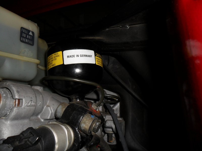

Ronnie Posted April 14, 2017 Topic Author Share Posted April 14, 2017 Is the brake pressure line a banjo bolt style hose? I don't have any experience with that style and those would likely be ones I could not test directly with my gauge setup. I doubt the brake fitting for the steel line, 3/16" European bubble flare, would be the same as the hollow bolt? I know that my master cylinder has a hose instead of a steel line but I've not noticed what kind of fittings it has. I will look at it and take a photo in a few minutes and post back what I find. Link to comment Share on other sites More sharing options...
Ronnie Posted April 14, 2017 Topic Author Share Posted April 14, 2017 I don't know my car as well as what I thought I did. I could have sworn that it had a hose but the photos show otherwise. The only hose that I could find goes to the reservoir. I wonder if my master was changed out at some point or if my car is a latter production car that came with the steel line? Link to comment Share on other sites More sharing options...
2seater Posted April 14, 2017 Share Posted April 14, 2017 Dave would know the best but that sure looks like the later model setup common to the '89 and '90. I wonder if there is a s/n where the switchover occurred? I think it is good news for you. Link to comment Share on other sites More sharing options...
DAVES89 Posted April 14, 2017 Share Posted April 14, 2017 From the picture Ronnie posted he has the '89/90 setup. I just sent over pictures for Ronnie to load. I knew there was a difference between the '88 to the '89/90 but I thought that could be overcome. There is a hydralic hose place near me that I may check into to see what could be done. 2seater, If I remember right the pump/motor you bought was off a Pontiac bonneville, but I know I pulled one off a '88 Riv that had the later set up. The '88 pump/motor set up might be very rare. Ronnie you and AzRon should post your vins so we can see what might be going on. If there are any other '88 owners it would be great if they chime in as well. I do have someone interested in my '88 pump/motor. If he passes, it will be available. Link to comment Share on other sites More sharing options...
Ronnie Posted April 14, 2017 Topic Author Share Posted April 14, 2017 From the picture Ronnie posted he has the '89/90 setup. I just sent over pictures for Ronnie to load. I knew there was a difference between the '88 to the '89/90 but I thought that could be overcome. There is a hydralic hose place near me that I may check into to see what could be done. 2seater, If I remember right the pump/motor you bought was off a Pontiac bonneville, but I know I pulled one off a '88 Riv that had the later set up. The '88 pump/motor set up might be very rare. Ronnie you and AzRon should post your vins so we can see what might be going on. If there are any other '88 owners it would be great if they chime in as well. I do have someone interested in my '88 pump/motor. If he passes, it will be available. Below are the photos of the '88 & '89 pumps sitting side by side for comparison. Dave will explain about them. I won't be needing the '88 pump since I have the later model pump on my '88 that has the steel line. I think my spare Teves unit is the later model as well that has the steel line. My car is number 4593 out of 4709 produced in '88. It would be interesting to know if any other '88 owners could check and report if their cars have the steel lines on the pump. I talked with the original owner of my car back when I purchased it and she told me the only parts that she remembered being replaced was the headliner but maybe she forgot about the brake pump being replaced? Link to comment Share on other sites More sharing options...
DAVES89 Posted April 14, 2017 Share Posted April 14, 2017 Thanks Ronnie. Both pictures are the same and can be enlarged by clicking on them. The pump in the foreground is the '88 pump/motor. You can see it has a different line and uses "banjo" bolts that are vented for bleeding the system. The pump in the back ground is the '89/90 pump/motor and uses a hard line that has brake line fittings. As you can see the lines are not able to be swapped so if you have an '88 Teves Master Cylinder and you want a pump/motor for back stock you need and can only use an '88 pump/motor. I am sure there is no difference between the pump/motors from year to year but the line was probably changed as a cost savings measure by G M. You can see that the line on the '89/90 would be far cheaper then the line used for the '88. All that needed to be changed was tapping the holes on the pump/motor and the Teves Master Cylinder. Link to comment Share on other sites More sharing options...
2seater Posted April 14, 2017 Share Posted April 14, 2017 I know it is unlikely, but I wonder what the hole looks like under the hose bolt? The hole for the tube is just a straight thread with a slightly dished bottom. The bubble flare tube seals against that dished surface and is simpler to make and use that the typical double flare. Link to comment Share on other sites More sharing options...
