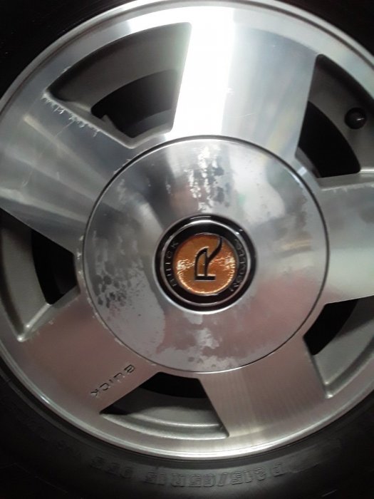

Bertimus 51 Posted January 25 Share Posted January 25 Disclaimer: I also inquired with this same post on the AACA Reatta forum 🙂 So I am at my wit's end with the center caps on the 88 brushed style rims. It seems even the second I first applied just plain old water the center caps began reacting badly (oxidation/foggin). Seems like most rim specific cleaners remove the finish. Even more perplexing is that when the finish is removed, so is the brushed/machined styling!! So apparently the machining/brush was applied to the finish and not the aluminum itself? Does anyone know anything about this or why this happens? Once the finished is removed it begins to luster into a chrome, which I have seen done quite a bit and looks awesome, but is personally not my cup of tea, as I'd like to preserve the original look. Ps. none of this applies to the rims, they are not hyper-sensitive like the center caps. So what maintenance methods have worked for you guys as far as persevering the original brush style? Eventually (when I have the extra cash, which means not any time soon lol) I want to get the caps and the rims completely remachined. I saw on a post by gentleman who had it done by Hubcap Heaven in Tennessee, and they look gorgeous, but I am having a hard time even finding that service here in southern california (if any of you know of a place post it here!) Also, if any of you have successfully restored the brushed styling yourselves, your DIY knowledge would be greatly appreciated Thank you 🙏🏽 Pictured below: 1. Condition when I bought the car (standard wear and oxidation) 2. The unfortunate state it's in now 3. An example of the usual approach (stripped + chromed) 4. Example of a remachined rim+cap by Hubcap Heaven in Tennessee Link to post Share on other sites

Bertimus 51 Posted February 7 Topic Author Share Posted February 7 (edited) 8 hours ago, Danpatters583 said: Once you get them machined you can get them powder coated with a clear powder. That way it keeps the nice look but will keep clean and all that for many years to come. Yeah I definitely without a doubt want to get them remachined and recoated (when I save up what I'm guessing will be at least $600 here in CA). Maintaining the original finish has been nothing but a pain, it makes me want to just give in and strip and polish them into chrome just not to deal with it anymore (a good solution if you can't afford to remachine them, and it doesn't stop you from remachining them in the future). I thought the rims were immune to reactions, and just last night I was cleaning a rim with a gentle waterless wash and sure enough, it began clouding up, badly. Luckily my handy Flitz metal polish was able to salvage it (took more than an hour to repolish) and still maintain mostly all the steel brush style grain. But just note: I remove the center caps whenever I use Flitz, because it will DEFINITELY strip the machined finish off the caps. The trials and errors these wheels have been putting me through I tell you🤦🏽♂️🤦🏽♂️🤦🏽♂️ Edited February 7 by Bertimus Link to post Share on other sites

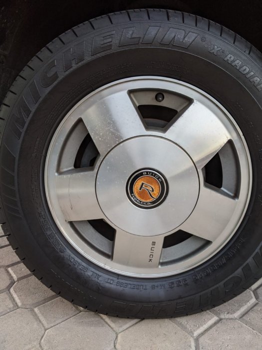

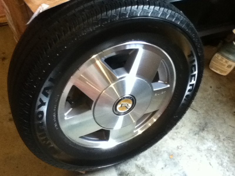

Bertimus 51 Posted February 7 Topic Author Share Posted February 7 (edited) Here is what I learned about the wheels and the center hubcaps: If you're dealing with the original finish, the caps should be treated like newborn babies. Rub them gently with a gentle compound to clean them. Then gently rub a gentle non-corrosive polish, and then wax. That's it, nothing more and nothing less. The wheel/rim's are machined into the metal itself, so it's not likely you'll strip the grain (unlike the caps, which are stripped if you just look at them too hard), but the finish is a different story. Last night I cleaned one wheel with a gentle wash, and it came out stunningly. I confidently moved on to the the next wheel and it immediately began reacting severely and clouding up like a winter's morning in Oregon. These wheels and caps have minds of their own. So I no longer experiment with cleaners. Like I mentioned above, an hour plus of polishing with Flitz metal paste polish remedied the accidental clouding. A little bit of the finish was unfortunately lost but not very noticable after polish/wax. So for maintenance, repeat the same center cap process for the wheel, but you can use Flitz Metal Polish confidently, as opposed to the caps, which I do not let anywhere near the Flitz. Pictured below is the result of my sweat and tears. I want to thank JIM FINN for supplying me with near mint caps, and for the maintenance tips. You're the man Jim! 🙏🏽 Edited February 7 by Bertimus 3 Link to post Share on other sites

Ronnie 405 Posted February 7 Share Posted February 7 Your wheels turned out great! Looks like a new wheel in your photo. 1 Link to post Share on other sites
DAVES89 336 Posted February 7 Share Posted February 7 The wheels look great. I agree with Ronnie, they do look like new. 1 Link to post Share on other sites
