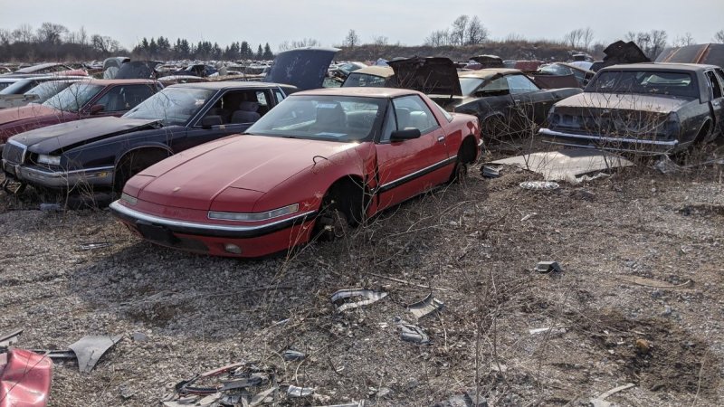

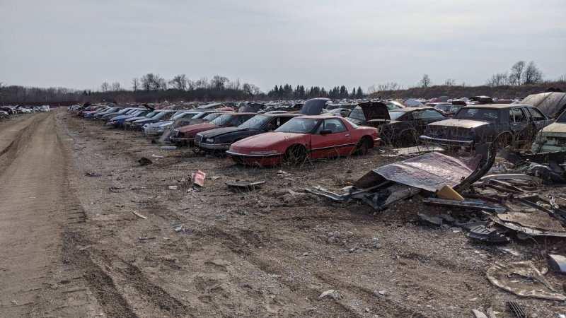

I am not a Reatta owner or particularly interested in these cars, but I'm a car enthusiast in general and appreciate old/weird cars. I spend my free time roaming salvage yards and recently came across this Reatta. It is a new addition to this salvage yard and I couldn't help but think that this car is too nice to deserve what's coming to it.
If anyone is interested in saving this car it's located in eastern WI. Daves89, I see you are in Menasha, WI. Do you know anything about this one?

Welcome to the forum Mark. Thanks for taking the time to let us know about this Reatta.
It would be helpful if you told us the name of the salvage yard.
Mark D
No problem! Even if it can't be saved whole, at least there are a lot of usable parts. I'm not seeing a lot of rust or anything so who knows why it ended up where it did. That damage on the LH side fender/door may have been enough for an insurance company to total it.
Hopefully someone here can do something with it.
That frequently happens with these cars. Body parts are hard to come by compared to others cars and expensive to ship because of their size. Body shop labor has got so high sometimes it doesn't make sense to repair them.
