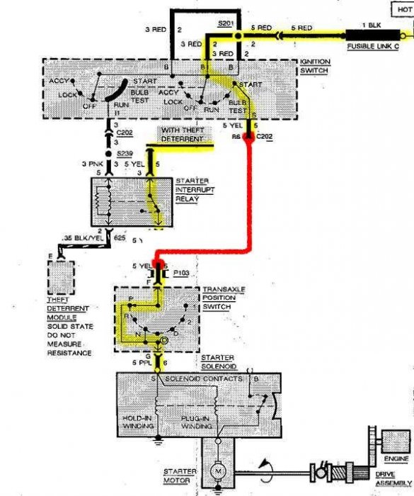

2seater Posted October 8, 2020 Topic Author Share Posted October 8, 2020 It looks like the red car may have suffered a starter failure. Got the call last night, in the parking lot of school. Looked at it this morning with grandson doing the things that verify the dash and steering column changing didn't leave a loose end somewhere. Dropped the column, verified the yellow wire from the ignition switch appears to send power out when the key is in start, so the key lock and ignition switch are communicating through the connecting link. Replaced the starter interrupt relay because it was easy but didn't help. The car will not crank at all. There is no sound at all from under the hood when the key is turned to start. The relays on the firewall all click when the key is turned on as well as the brake booster pump runs. The only peculiar sound is from the IAC when the key is released from the start position. It is a sort of squeak or cheep so disconnected that for now. Everything inside the car works, no codes. The headlights do not dim at all when engaging start position of the switch, so definitely no draw from the starter at all. Verified 12.2v at the battery. Will be back at it tomorrow morning after looking for a starter today. If there are any thoughts short of replacing the starter, would be happy to investigate. Link to comment Share on other sites More sharing options...

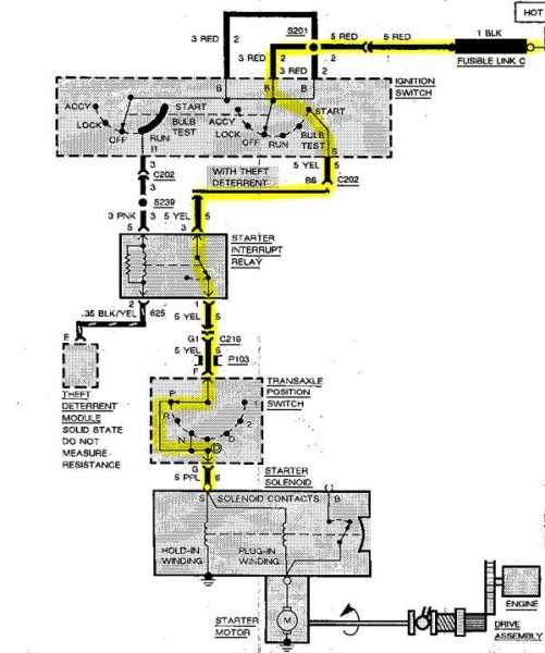

Ronnie Posted October 8, 2020 Share Posted October 8, 2020 Don't overlook the Park/Neutral switch. The P/N switch is a good place to do some testing to see if power is going to the starter. The photos below might help. The one with the red lines will show you how to bypass the starter interrupt relay if you suspect that might be the problem. Link to comment Share on other sites More sharing options...
DAVES89 Posted October 8, 2020 Share Posted October 8, 2020 Ronnies idea is a good one and believe it or not this is what happened on the Black that your son now has. Just look along the steering column/Teves unit and you should see a soldered connection. There is a long series of posts between mostly "Snowdrift" and Ronnie on it "over there". Link to comment Share on other sites More sharing options...
Ronnie Posted October 8, 2020 Share Posted October 8, 2020 48 minutes ago, Ronnie said: The one with the red lines will show you how to bypass the starter interrupt relay if you suspect that might be the problem. I should have said you could jumper the starter interrupt relay as shown in the photo as a test if you suspect it might be a problem. The guy Dave was referring to did have a problem with the security system and he bypassed the relay. That is were the photos I posted came from. Dave ended up buying the car. Link to comment Share on other sites More sharing options...
2seater Posted October 9, 2020 Topic Author Share Posted October 9, 2020 (edited) Thanks for the input fellas. #2 son convinced me we should all see if we could get the car going tonight, so we all met in the parking lot where the car lay. The three grandkids were all present which was sort of appropriate as they helped get it where it is today. I did pick up a reman starter from the local rebuilder so I was prepared. We managed to push the car over to the side of the parking lot so we could spread out without being in the way. Trolley jack and ramps provided enough clearance to get to the starter and after a bit of colorful language, the starter was out. We did a jumper cable starter test and of course there is nothing wrong with the starter. We would have tried a hotwire in place but the terminal seemed inaccessible without removal. This at least gave us the opportunity to put a meter on the starter engagement terminal and got a whopping 0.48v with the key in start, a pretty good reason it doesn't engage. With darkness coming on, we thought the car would likely start if we hotwired the start terminal to the battery and with the ignition key in run, just a touch to the start terminal and the engine started instantly. There is no doubt the problem lies in one or both of the suggested spots for a bypass. The ignition switch terminal with the yellow wire output battery voltage in the start position, so both ends of the start system are working, but not in between. This at least allowed us to relocate the car to a more hospitable location for detective work. More on that later. I will add the human side of this story: #2 son burns the candle at both ends and in the middle, a definite type A, and he didn't get that from his dad. Always short of time, he was scheduled to drop the 8yr old grandson at his former wife's house, about 30 miles away on his way back home, another 15 miles further. With the Reatta running, he decided to use it to drop his son off and drive home, or possibly continue on to my cottage, another 13 miles further yet. The car #2 son brought to the party is his do everything hooptie mobile, a '03 Honda Civic hybrid with over 300k miles on the original drivetrain. This left the Reatta driving grandson with the hooptie Honda to take his sister home, where they both live and is in the same city as the school. I did offer to let one of them take my Subaru but mercifully they refused? I haven't heard if he made it home or if he went to the cottage. I had suggested if he would drop the Reatta at the cottage to take the Ford Ranger that spends its summer in storage so he would have wheels. That needs to be pulled out anyway as my four post lift goes in on Saturday.? Edit: just got word the Reatta went to the cottage and he did take the Ranger so everyone is safe, although grandson driving the hooptie Honda might disagree Edited October 9, 2020 by 2seater 1 Link to comment Share on other sites More sharing options...
2seater Posted October 11, 2020 Topic Author Share Posted October 11, 2020 Got back to the red car today to look into the no start condition which after we thought had been cured with a anti theft bypass it turned out the neutral safety plug connection was apparently poor and proved to be pretty ugly on the inside. Cleaned it several times and the car now starts without fail. Fingers sort of crossed on this since we initially thought the anti theft bypass cured the problem but we were wrong. We installed the headlight harness on the red car as well which took maybe a half hour working alone. Much quicker than the first one. My new lift went in this morning and the red car got the first ride. This allowed us to look over the work done flat on our back and marvel at the decent and neat job, but wondering why we didn’t have the lift sooner? While underneath it looks like the possible source of an occasional clunk under the right front is a broken end link on the anti sway bar, easy fix but also found the power steering hose from the pump to the rack is leaking where the flex line connects to the steel tubing. Darn it. Link to comment Share on other sites More sharing options...
