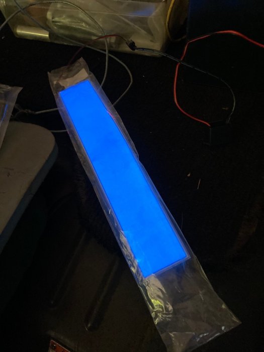

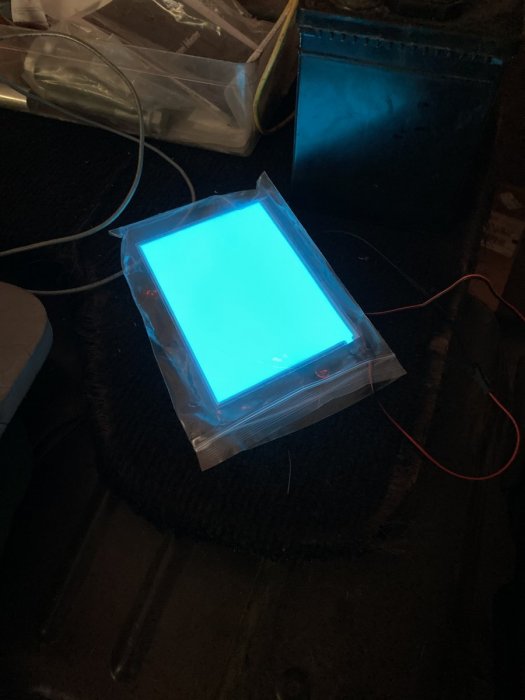

2seater Posted September 19, 2020 Topic Author Share Posted September 19, 2020 I guess #1 son with the black car did continue to investigate the shifter lighting. It turned out he found something that was a variation of the led strips Dave had invented. He found electroluminescent sheets on the Walmart site of all things. Used the 12v feed Dave had provided and it comes with a little black box that is either an inverter or transformer? In any case, when cut to size it just slips between the two parts of the original assembly and backlights the entire assembly. Example below. The lighter color is a good match to the dash and while well lit, it isn’t obtrusive or overpowering. He is going to try the same tech on the switches in the console but not high hopes for that. Link to comment Share on other sites More sharing options...

2seater Posted September 20, 2020 Topic Author Share Posted September 20, 2020 Yes, the stuff available for little money is impressive. A quick look reveals multiple colors, sizes and configurations. I should have clicked a pic of the actual shifter. It does lack the selective lighting for the gear position but the look is very nice. He has a neighbor that has a 3D printer and he showed me one of the replacement pieces for the ends of the door straps like a few others have done. Apparently he is a tinkerer like my son but the funny thing was this same guy came back with an excerpt from the ROJ where he was looking for a replacement for the dimming photocell and came up up with a Kdirk Radio Shack thread. Funny how a guy uninvolved with Reattas came here anyway Link to comment Share on other sites More sharing options...
