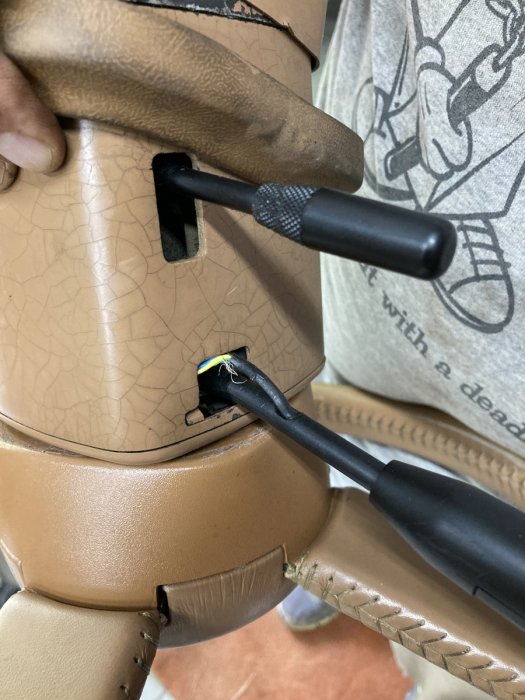

DAVES89 Posted August 20, 2020 Share Posted August 20, 2020 When Bob and I were goofing around with the cruise he pulled the cruise switch out and "rebuilt" it by cleaning the contacts. He also jumped the cruise wire at the directional lever down to the switch and it still didn't work. It was only later that I realized that the headlight switch was no good that caused the cruise not to work. At any rate the cruise will not work at all because the cruise switch at the brake pedal is not installed and is just laying there. In all my years of being on the forum I have never remembered anyone having a cruise issue that was due to a bad wire. It was always a switch, servo, or headlight switch. But Kendall [without testing] said it had to be the wire as that was his experience with Mopar cars. It doesn't apply to Reattas but as he is so knowledgeable we followed his opinion and in this case may have done more damage then fix. Regarding the ignition switch, it is the black box that is on the outside of the column at the bottom of the column. I would only want it if you take the column out of the Red car because you couldn't get the cruise to work on that column and then didn't need it. As a matter of fact if you replaced the column and didn't need it I would be interested in the whole column for parts. Link to comment Share on other sites More sharing options...
Ronnie Posted August 20, 2020 Share Posted August 20, 2020 On 8/19/2020 at 8:21 AM, DAVES89 said: That is what Padgett said over "there" and I didn't argue the point. I did try it on the Red at all speeds before closed loop and the cruise comes on at least 20 miles an hour and works when the engine still shows cold on the CRT. You are right Dave. I just tried to engage the Cruse with the engine cold this morning. I can also confirm that the cruise will work when the engine is cold and in open loop. We can lay that one to rest. Link to comment Share on other sites More sharing options...

DAVES89 Posted August 22, 2020 Share Posted August 22, 2020 I just remove the lower hose at the radiator. Also sounds like a wheel bearing, as you know I have some. Also I would just swap the column from the donor and your cruise should come back, because I violated my own rule about if something goes bad it is an end component and never the wiring, so I am sorry about that. Let me know if you need anything as I have some new parts and as you know lots of good used parts. And as I will be out by Bob's next week I could even deliver... Link to comment Share on other sites More sharing options...
