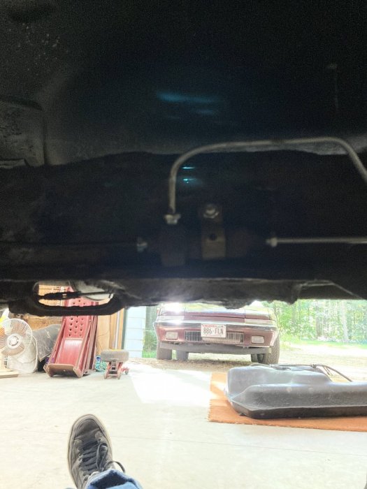

2seater Posted August 15, 2020 Topic Author Share Posted August 15, 2020 I do not know what is leaking or how it was determined . Dave had told me there was a leak up in the firewall area so it wasn’t a surprise, however #1 son is a little sparse when it comes to communicating. He is more of a doer rather than a splainer ? He will be here tomorrow to get parts, help on the red car and raid the beer fridge. The parts car I have didn’t start out that way, much like the red car Dave had. I paid too much and a cloudy future for it. The combination of the two cars is almost like it was meant to be one. Haven’t done much of anything up front in the engine area or underneath, so I am sure there may be a need for parts from Dave’s stash. 2 Link to comment Share on other sites More sharing options...
2seater Posted August 17, 2020 Topic Author Share Posted August 17, 2020 Saturday: A little information update on the a/c leak for the black car #1 son has. He added leak detection dye and showed me a cracked line right down near the compressor. If this is correct it is the pressure line to the condenser, part of the manifold attached to the rear of the compressor. He did say the sound of the leak gives the impression it is up on the firewall, probably a reflection, or there is more than one. Looks repairable to me with parts from the donor. Back to the red car: Found four broken or repaired wires in the hinge area of the drivers door, main power and one function for the seat, power to the mirror and the courtesy light. A Carfax reveals the car was totaled quite some time ago, probably why the drivers door and front fender are from two other donors, but the title is clean. We found the door harness is full length from the door interior, along the rocker inside the car and then across to the console with no junctions to disassemble. The wiring used for the repairs was all black with the butt connectors in the hinge area and inside the car near the park brake. We pulled a short section of 12/5 cable through the hinge area and made the splices inside the car and inside the door itself so there is no stress on the repairs. All door operated function work properly now. Swapped just the drivers seat back with the donor car to make a very presentable combination. Refilled and bled the brake system, found a couple leaks along the way, but the system is now leak free. Looking forward to be able to give it a good try. Reinstalling the fuel tank turned out to be an adventure. Even with two of us working on it, it just seemed like it was determined to snag on everything possible but we did finally get it approx. in place leaving on side loose to better access the fuel line connections. In hindsight the feed and return hoses should have been connected to the tank prior to installation but didn't want the unfinished extra long hoses in the way. Big mistake. Knocked off for the night. Sunday: Working alone I installed all the connections to the tank. Had the hoses on the new filler pipe clocked 180* off so remove and repair to allow connection, then the fuel lines and charcoal vent tube. Very limited space to tighten the threaded fittings at the top of the fuel tank. You know the story, get the wrench on the fitting, but no room to swing the wrench. Finally seems tight, push the tank up and finish the second support strap. Add five gallons to tank, turn the key on, no indicated pressure on the gauge, and find a puddle under the car. Place fan blowing under car to dry and ventilate, clean up and go have a beer with the neighbor. Tomorrow is another day and the tank will need to be lowered to find the problem and repair. Oh well? Link to comment Share on other sites More sharing options...

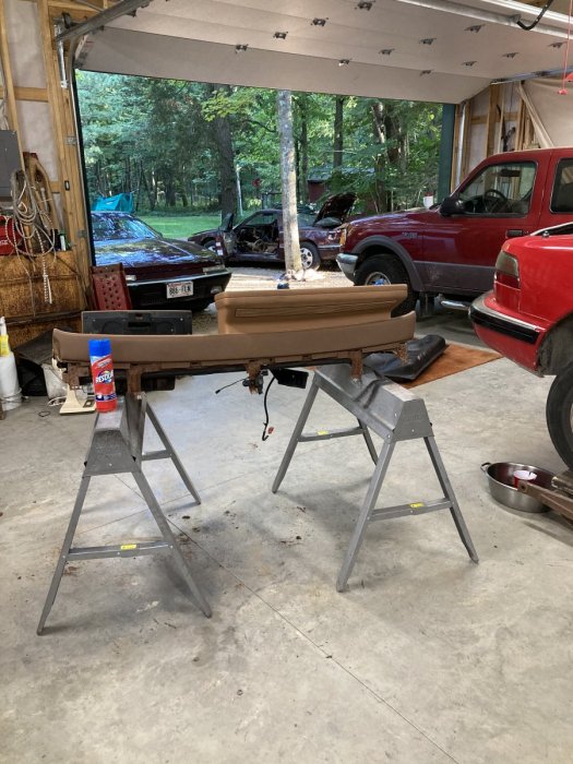

2seater Posted August 18, 2020 Topic Author Share Posted August 18, 2020 Interesting and also frustrating day today. Had to drive into town to replenish a little food and pick up some other supplies so didn’t get going until after noon. Shortly after getting back, #2 son and teenage granddaughter came by for the purpose of removing the dash from the donor car. The two of them worked all afternoon to get the entire assembly out by going back and forth to Dave’s instructions following the described order of operation. Minor issues but the tools and locations are spot on and my son was very complimentary of the accuracy and clarity of instructions. I was impressed myself but it was for the gumption to tackle that job. It is worth it as the dash is in great shape. A side benefit is the easy access to the boxes and wiring to maybe repair the dash failure of #1 sons black car? The fuel tank story was less positive. If the fuel hoses were attached to the tank before installation I would have noticed the main pressure line from the tank was seized to the nut that couples to the hose running forward. Working with no space, what felt like the two mating pieces threading together, was actually the fitting end from the tank twisting off. The tank had to come all the way out so the steel pipe could be cut cleanly and it is getting pressure hose connected directly to the bobbed off steel line. The best repair would be to replace the entire in tank assembly but it simply isn’t going to be. I am sure this solution is secure but not perfect? End is story for today. This is the donor dash on sawhorses for cleanup. My car in left background, donor in right background and rear corner of subject car extreme right. The other thing is of different manufacture? 1 Link to comment Share on other sites More sharing options...

2seater Posted August 19, 2020 Topic Author Share Posted August 19, 2020 It is true everyone is pitching in and I am a very lucky guy, for sure. #2 son and granddaughter came back today. Son had the day off and granddaughter was planning on some school activity but decided she wanted to work on her brothers car instead. Hard to beat that. The two of them had the dash out and the replacement from the donor back in in about three hours, just as Dave said. While other things were going on, granddaughter worked on cleaning all the replacement parts, scrubbing the panels, bleaching suspect areas. A real trooper. Fuel tank finally back in place and no leaks. It did take four prime cycles to get the pressure up to full at the rail but everything was completely empty to start. The pump is so quiet, Delphi turbine, I will have to try with my hearing aids to see if I can tell it is running. I was under the car and the tank looking for leaks while priming and I couldn't hear it there either. The car now starts without external aid but it is not an instant response. A little lazy when blipping the throttle so things to look at next. Grandson arrived late after work and school. After pitching in to investigate and work on misc. interior items, we had the chance to start the engine, and I had the chance to walk him through some of the touch screen although I am not very well versed in the '89. He is looking forward to making it his daily driver. We noted a current 041 code, so with the miles, timing set, magnet and sensor on in the near future. Noted the engine never went closed loop and the O2 sensor was pretty much unresponsive, Integrator and BLM stuck on 128. Almost ready to get to the front end of the car so with much of the family working the middle and interior, I am free to look in depth. We want to get the car down and driving to check the cruise control before deciding on the whole column or just the steering wheel. Daughter in law came after work and she has been addressing the broken latches and mixing and matching parts from the two cars to get them all correct and keyed alike. The interior is looking very good indeed. Side note: just received a text from #1 son about black car with the dash failure. He found the cps fuse was bad but in a strange way. Not blown in a conventional fashion but one side above a prong was sort of corroded looking. Swapped the fuse, and all functions returned. Maybe more collateral damage from the owner prior to Dave?? Will see if I can get the photo he sent me posted. Link to comment Share on other sites More sharing options...

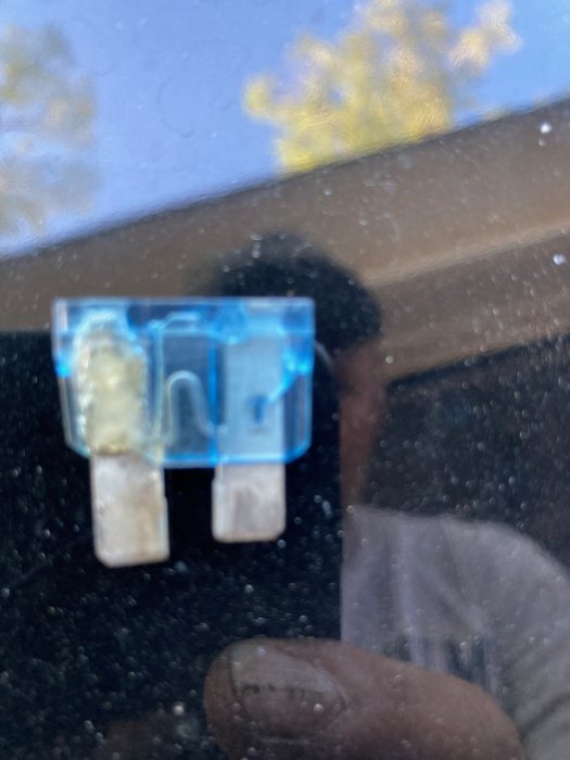

2seater Posted August 19, 2020 Topic Author Share Posted August 19, 2020 Two photos: the fuse mentioned above. The CPS fuse for the black car. Odd looking failure. The other photo is of the relocated brake proportioner valve. I didn’t realize how poor it looks and will see if a better one can be taken but it is placed on the rear crossmember and one brake hose is eliminated. Third one done like this Link to comment Share on other sites More sharing options...
Ronnie Posted August 19, 2020 Share Posted August 19, 2020 Good progress being made! Good find on the fuse. The left side of the fuse looks like it might have overheated even though it doesn't look like it's blown. I would check to make sure the slot where the fuse plugs in a holding the blade tight. Link to comment Share on other sites More sharing options...
DAVES89 Posted August 19, 2020 Share Posted August 19, 2020 I don't believe the cruise will ever work. When the cruise stopped working Bob pulled on the wire and found a break in the wire. He put a jumper lead from the break down to the switch. But of course as I later found out, the headlight switch that came with that car was no good. Also the cruise switch is disconnected at the brake pedal so you may want to check that. If you do swap the column could you consider letting the ignition module [that is located on the column] go? I would like to have one for my inventory. Link to comment Share on other sites More sharing options...
DAVES89 Posted August 19, 2020 Share Posted August 19, 2020 Regarding that fuse. Once again I believe that is "fall out" from the arcing "Snowdrift" had when he shorted out the alternator. As you have seen it goofed up the headlight relay pins so bad Kendall had to pull the pins and move them so he could make them tight enough. There was talk at the time of getting a different fuse box and installing it, but because the headlights [and everything else] continued to work that all quieted down. I didn't see anywhere that your son resolved the fog light issue? I'm laying money on the switch [either the console or the dash]. I would start with the console. Take it from the "donor" maroon and try it as once again I don't believe any wire is going to be the issue. Link to comment Share on other sites More sharing options...
