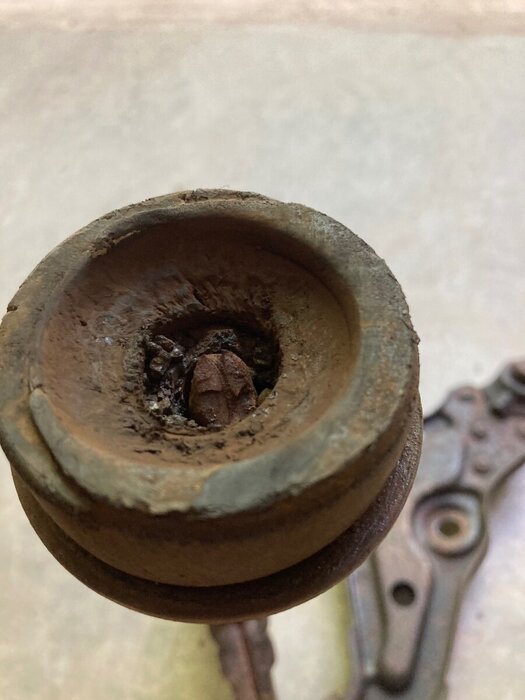

Ronnie Posted July 24, 2022 Share Posted July 24, 2022 Would it be possible for me to remove the nut, washer and rubber bumper from the end of the rod on my car and tell if there is excessive wear where the rod moves in the subframe when the brakes are applied? Link to comment Share on other sites More sharing options...
2seater Posted July 24, 2022 Topic Author Share Posted July 24, 2022 58 minutes ago, Ronnie said: Would it be possible for me to remove the nut, washer and rubber bumper from the end of the rod on my car and tell if there is excessive wear where the rod moves in the subframe when the brakes are applied? I think so. The photo is the end view of the one that broke and the wear point appears to be pretty much all in the area between the bushings. 1 Link to comment Share on other sites More sharing options...
