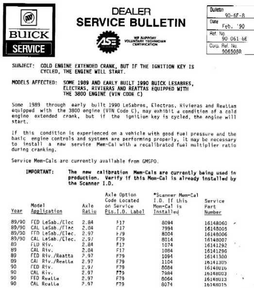

2seater Posted August 29, 2021 Topic Author Share Posted August 29, 2021 The red car came back to the cottage last night. There is a concern about long cranking time after sitting for a day or two. I thought it might be similar to mine which usually fires instantly but occasionally requires 5-10seconds? In this case, it does indeed require a very long crank after sitting overnight, maybe up to a minute in a couple of attempts, once started, it ran perfectly. Son also stated it would start perfectly the rest of the day after the initial problem. Fuel pressure was checked before the first starting attempt and it was perfect at 43psi indicated. I let it warm up and started to go through the diagnostics, which had both high and low TPS voltage codes and ED01 was indeed about .58. The warm idle was high but would occasionally idle down and I found the TPS indication would wander around a couple tenths with no input? Tried adjusting the TPS unsuccessfully. I would get the voltage down close to the target and the next little nudge would send the voltage all the way to the top, about 4.98v indicated. The donor car gave up its TPS. Not preferred, but in the middle of the woods anything may do. After the standard cussing about the location of the TPS, the donated one was installed and adjusted with engine off. On startup, it idled very high, 1500 rpm or so, similar to the issues that Jon was having. I went into the menu and forced the IAC to close to get the idle down, just to prove the IAC was capable of slow idle, which is was. The engine started quickly and checking the indicated TPS I found it a couple tenths low so attempted tiny adjustments with the engine running and found the tiniest adjustment to the TPS would cause the engine to idle up with no other input. It would idle back down on its own but I was surprised just how sensitive it is to small changes, even within the normal range? I am just speculating the out of whack TPS may have something to do with the hard cold start but only leaving it sit overnight will tell the tale on that. Maybe I will now get the chance to check out the ABS codes. 1 Link to comment Share on other sites More sharing options...
Padgett Posted August 29, 2021 Share Posted August 29, 2021 (edited) After sitting a while try this: turn on to run but do not start, wait three seconds then turn off, wait 2 seconds. Repeat three times. Then try to start. This should give an eight second shot from the fuel pump instead of two seconds. Edited August 29, 2021 by Padgett Link to comment Share on other sites More sharing options...
2seater Posted August 29, 2021 Topic Author Share Posted August 29, 2021 I will pass on the multiple prime suggestion. Prior to me looking the car earlier today I connected a fuel pressure gauge and the normal single prime cycle brings the pressure up to ~43psi. It definitely has fuel, but if it gets in the engine is of course a different question🙄 The diagnostics displays PROM ID 2204 This hasn't been an issue up to this time that I am aware of, but it is someone else's possession? Appreciate the suggestion. I went through the ABS codes, multiple times because a couple don't show up in the codes in the diagnostic page. I have codes 28, 13, 38, 42 and 78. The first two don't seem to exist in the charts? 38 and 78 are both for the left rear sensor and 42 is right front sensor, but If memory serves, these are actually reversed? Even though this is an '89, it has an early '88 Teves unit with the pressure hose rather than the steel tube. I don't know any history how or why that could be. Link to comment Share on other sites More sharing options...
