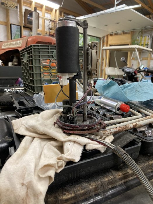

2seater Posted August 10, 2020 Topic Author Share Posted August 10, 2020 It is genuinely fun as a family project. Both my boys will be Reatta owners which should prove interesting. They actually pushed pulled and dragged my derelict turned donor car out of the corner of the shed so easier to access and hopefully let the mothball fumes thin out? Now that it is sitting outside it doesn’t look too horrible, but I need to turn a blind eye to it or be distracted. Since it was easy stand up work, on sawhorses, started on the fuel pump replacement. Right away I noticed the lock ring and o-ring gasket has red grease on it, dirty but not dried out, making me suspect someone had been in the fuel tank even though I don’t remember any notation in the notebook history in the glove box. It looks like the Mobil 1 synthetic grease I use? After looking at the pump assembly it all looks clean but there was no factory installed pulsator and the short substitute hose had no clamps. Both the pump and fuel outlet pipe are straight fittings with no barb or expanded tip to retain a hose and the hose was an easy slip fit, which leads me to believe the hose leaked fuel pressure rather than the pump being at fault?? Link to comment Share on other sites More sharing options...
DAVES89 Posted August 10, 2020 Share Posted August 10, 2020 Sounds like you might get lucky and have it be an easy fix. Unless you are going to put new parts in anyway? 1 Link to comment Share on other sites More sharing options...

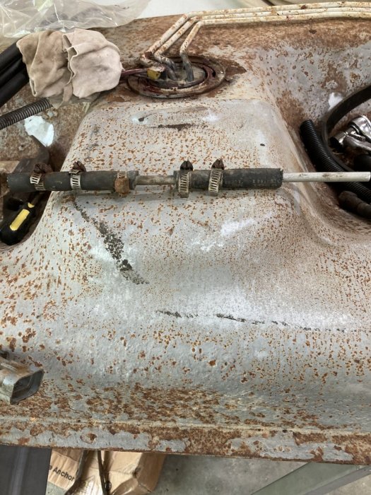

2seater Posted August 10, 2020 Topic Author Share Posted August 10, 2020 The joy of pulling a fuel tank is lost on me, so it is getting a new pump, dock filter and actual hose clamps on the outlet. It looks like the fuel line may have been spliced in the past? Link to comment Share on other sites More sharing options...
DAVES89 Posted August 10, 2020 Share Posted August 10, 2020 I am almost to the age where even pulling parts is losing it's "joy" factor for me. Also doing repairs, which is why I was so interested in getting rid of the two cars your son/grandson got. When my new Black dies, it will be the Red's turn as a full time year round driver. It would have been the 'vert after the Red, but it dodged the bullet moving to Brownsville. That is why I sprayed what I could with undercoating on all the cars [the Red, 'vert, and Black] to slow down the rusting on any car that ends up being driven in the winter. Link to comment Share on other sites More sharing options...
