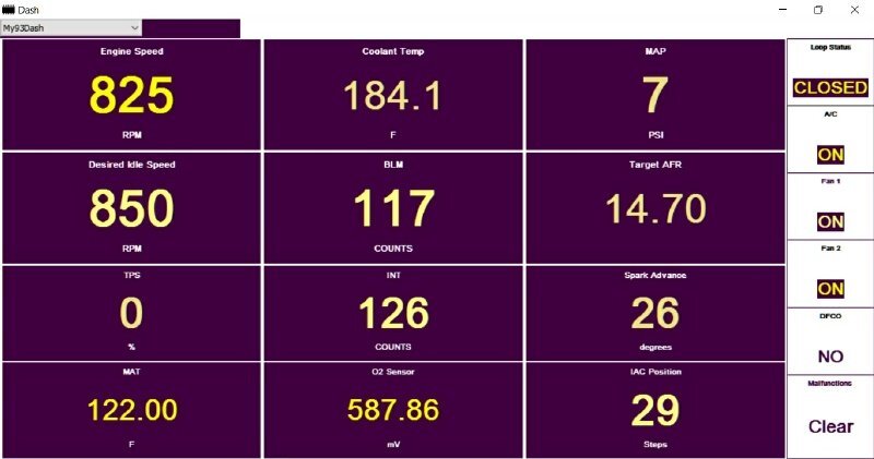

Padgett Posted December 3, 2022 Share Posted December 3, 2022 (edited) In GMese the "electrical control system" is a serial LAN known as the Assembly Line Data Link (ALDL) & was used in ALL GM cars from 1981 to 1995. The Reatta and a few other GM cars of the period have a built in scan tool. An OTC2000 scanner with a later "pathfinder" cartridge and GM ALDL cable is able to access the link. Are often found on eBay but I prefer TunerPro RT since it can display many parameters at once. ps the ALDL cover under the dash is marked "do not remove". It completes the loop. Edited December 3, 2022 by Padgett Link to comment Share on other sites More sharing options...
