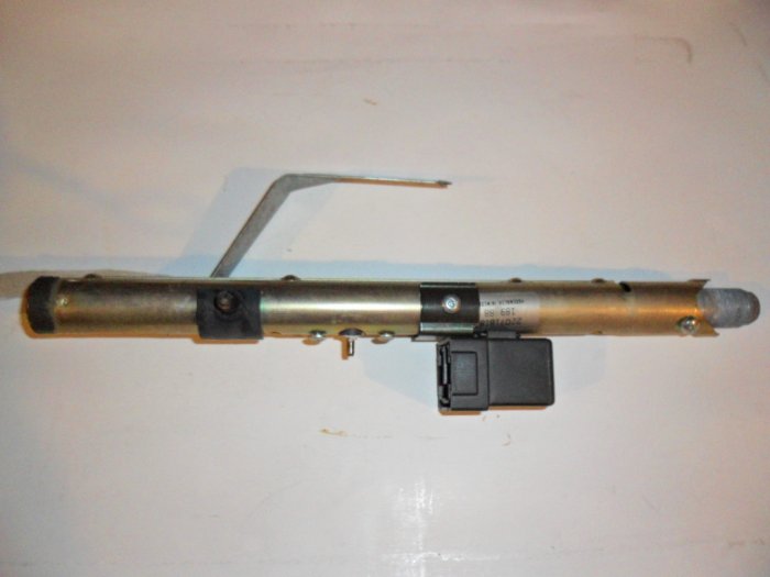

Ronnie Posted November 25, 2016 Share Posted November 25, 2016 I replaced mine when Dave was here a couple of years ago. I don't remember anything but unplugging it. I could have took a couple of screws loose. Maybe Dave (DAVES89) will remember how to do it. Below are couple of photos of my old antenna that might help you. Link to comment Share on other sites More sharing options...
