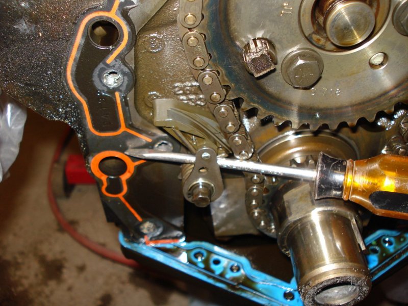

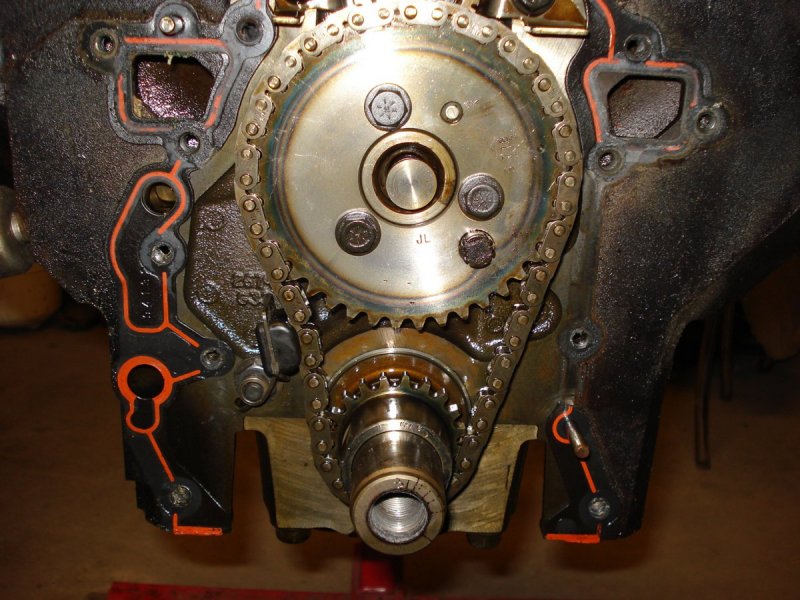

2seater Posted December 13, 2019 Share Posted December 13, 2019 I am reposting these from the other site and many years ago. This is the best I could find to illustrate the different chain damper styles and my experience with them. The totally worn out new style damper was run approx. 38k miles on a new Cloyes brand chain. The other pic is of the old style damper with 92k miles on it from a different engine but installed in place of the new style just for illustration. The old style damper was from my original engine which also used a Morse brand chain which has a smoother top surface. As can be seen, there is significant wear on the old damper but is no where near worn out with far more than double the miles. Three observations of the two different dampers: one, not scientific but a spring loaded center punch indicated the new style damper is softer material than the original, two, the new style is not a solid piece but is relieved underneath for lord knows what reason which is made worse since the chain just rides on a single point until it has worn in to conform to the amount of chain deflection but by then it cuts all the way through and accelerates the wear. The new design looks like it should lay smoothly against the chain for a large contact patch but it does not. The new style may work better against the oem Morse brand chain, but I haven't accumulated enough miles to prove that. Link to comment Share on other sites More sharing options...
DAVES89 Posted December 13, 2019 Topic Author Share Posted December 13, 2019 Thanks for the pictures Hal. As you know I have ordered the OEM damper from that dealer in Ohio and now because of your research I feel very confidant that after installation I will get many years and miles from the car. Kendall is doing the work as a trade for some paver brick work. He does the timing chain R&R and I do paver brick R&R on his patio. His knees are getting bad and mine are still pretty good and you and I know how skilled he is around engines so for me it is a great trade. I'm going to get him to do the 'vert as well. The 'vert has about 130,000 miles on it and has a bad cam magnet. Link to comment Share on other sites More sharing options...
