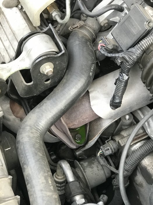

Dfk88 Posted November 25, 2017 Share Posted November 25, 2017 So I was on my way home from work this morning when at at stop light I noticed there was a little bit of steam coming from under the hood, I questioned it but it wasn’t much and I figured it was probably just a fluke, but when I had to stop again there was a bit more so I knew something happened, I drove it all the way home and even threw on the heater just to make sure I didn’t Overheat. When I opened the hood this is what’s I got, hope this is cheap and easy, because I have a few days off right now where I can get this done and ready for when I go back to work. Link to comment Share on other sites More sharing options...
DAVES89 Posted November 25, 2017 Share Posted November 25, 2017 A quart of anti freeze and 2 clamps to go with the hose and you should be set. Get the preformed if you can as it looks and works better. Link to comment Share on other sites More sharing options...
