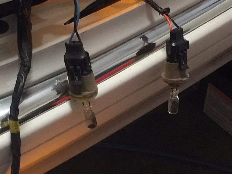

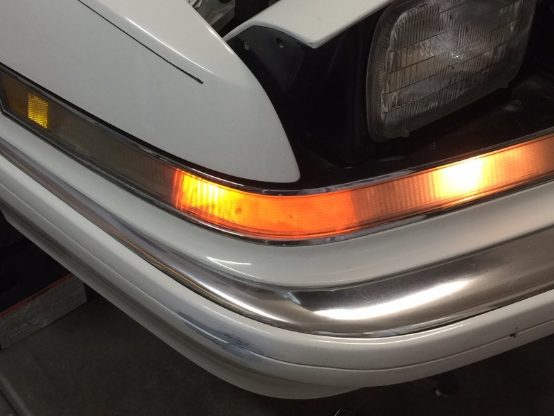

Frogware Posted October 17, 2017 Topic Author Share Posted October 17, 2017 Okay! So I started working on the lights today and wouldn't you know it the headlights are now working great :huh: But I will still check out the wiring to make sure it isn't breaking or fraying. Now on to the matter at hand, I took out the drivers side parking light housing and started repair on the broken orange globe then I started replacing the light bulbs. When I switched on the parking lights I was like what is wrong now!!! The blinker light does not light (Standby) but it will blink. I switched out the bulbs with several new ones and still the same result. The passenger side works other than I haven't started on it yet. I took a couple pics does anyone know off hand what would cause this? Yes I am using the stock GM 890 bulbs Edit: Oh I measured the voltage at the light and it is 0.0v but when I unplug it and test it at the plug contacts it reads 11.58v Thanks! Link to comment Share on other sites More sharing options...
DAVES89 Posted October 17, 2017 Share Posted October 17, 2017 Swap the relays that are in the relay center under the hood. I think that is your problem. Link to comment Share on other sites More sharing options...
Frogware Posted October 18, 2017 Topic Author Share Posted October 18, 2017 Swap the relays that are in the relay center under the hood. I think that is your problem. S U C C E S S !!! :D Thanks Dave! That is interesting can you explain this, why does one relay work in one position but not in the other? Link to comment Share on other sites More sharing options...
DAVES89 Posted October 18, 2017 Share Posted October 18, 2017 If I told you then what would you need me for? Actually I don't know, but I didn't figure this out on my own. Kendall my mechanic friend told me to try this when I had the exact same problem and it worked for me.. Link to comment Share on other sites More sharing options...
Ronnie Posted October 18, 2017 Share Posted October 18, 2017 ... I took out the drivers side parking light housing and started repair on the broken orange globe then I started replacing the light bulbs. When I switched on the parking lights I was like what is wrong now!!! The blinker light does not light (Standby) but it will blink. I switched out the bulbs with several new ones and still the same result. The passenger side works other than I haven't started on it yet. I took a couple pics does anyone know off hand what would cause this? I know you solved the problem already but what is bugging me is why you showed us a picture of the passenger side that you say works when you said the drivers side was the one that was giving problems. I must be reading your post incorrectly. :) Link to comment Share on other sites More sharing options...
Frogware Posted October 18, 2017 Topic Author Share Posted October 18, 2017 I know you solved the problem already but what is bugging me is why you showed us a picture of the passenger side that you say works when you said the drivers side was the one that was giving problems. I must be reading your post incorrectly. :) Hi Ronnie, Sorry Yeah I was trying to show the difference between the left & right. You are correct the passenger side was sort of working correctly. At any rate I am just happy that both sides work now. Link to comment Share on other sites More sharing options...
