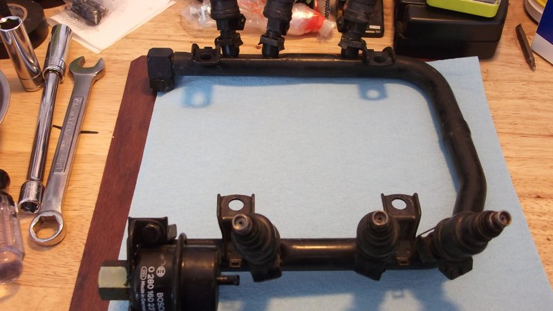

Today I started on the fuel system.  First up was a fuel injector rebuild kit and a new fuel pressure regulator.  I watched a couple of videos and started in.

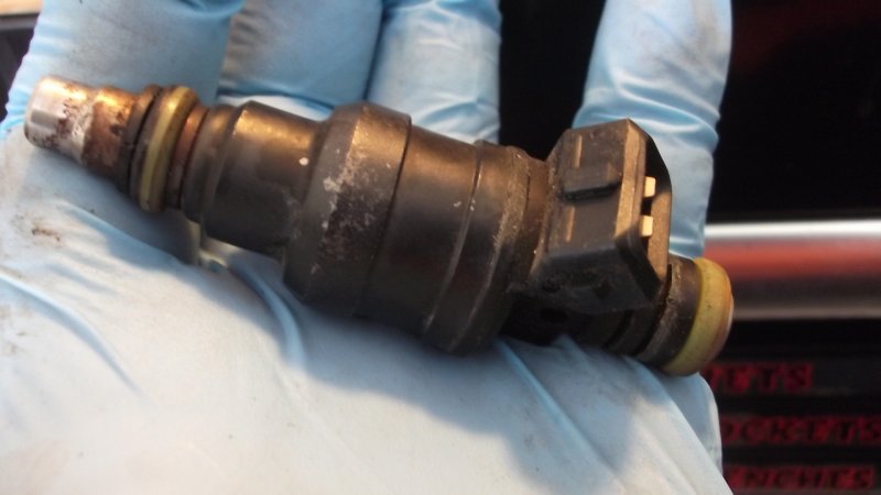

The rebuild consists of removing the old O rings, removing the internal filter in each injector and spraying injector cleaner into the injector to soak for a bit, blowing dry with compressed air and then  using new parts from the kit.  The kit came from NAPA and was priced in the $30s.  The kit had no directions and contained 12 O rings and 6 filters.
I Ohmed each injector and they were all very close to 15.

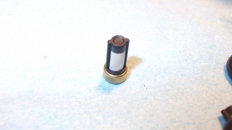

Someone here said they had a hard time removing the filters when they tried this.  I screwed a sheet metal screw into the filter, tightened the screw head in a vise and used vice grips.  I hammered the vice grips lightly and the screens came out nicely.

The You Tube vids I watched show installing the new filters with a drill press or a vice.  I tapped mine into the injectors with a small plastic/rubber hammer.  It worked great.
