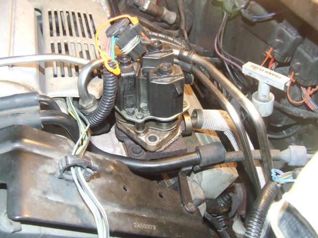

heygibb Posted August 30, 2017 Share Posted August 30, 2017 On 8/29/2017 at 4:00 PM, ski.dive said: How do I remove and clean the EGR valve? What is the black plastic CAP on top of EGR? Follow Ronnie's instructions. This is what you will encounter. Link to comment Share on other sites More sharing options...

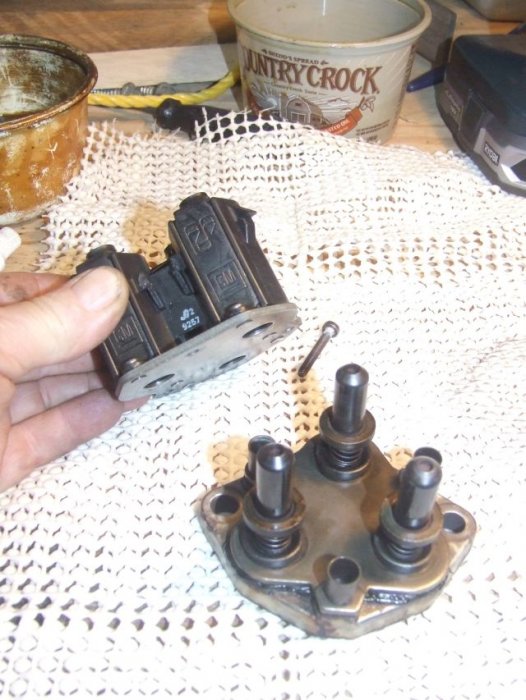

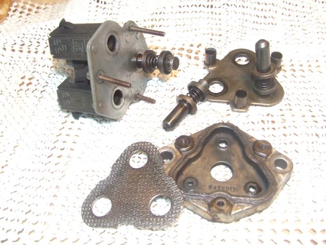

heygibb Posted August 30, 2017 Share Posted August 30, 2017 Link to comment Share on other sites More sharing options...

Ronnie Posted September 3, 2017 Share Posted September 3, 2017 Thanks for posting all the photos heygibb. They may come in handy to someone in the future. Link to comment Share on other sites More sharing options...
