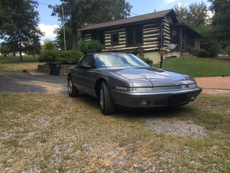

Ronnie Posted August 21, 2017 Share Posted August 21, 2017 Welcome to the forum Silver !! Glad you joined the forum. That's a nice looking Reatta you have. I just have the standard seats in my Reatta so I can't offer much help in answering your questions about the seats. I'm sure someone will come along shortly that will offer assistance with your problem. It does sound like you have something sticking that keeps the seat from moving. Link to comment Share on other sites More sharing options...
