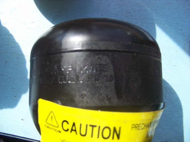

Ronnie Posted August 12, 2017 Share Posted August 12, 2017 I just checked the Hydac ball and it says 20. cubic inches in volume. There is nothing on the ball stating bar which I'm guessing is volume since the OEM ball say bar 0.25L. The Hydac ball also says made in the U.S.A. Where were the OEM balls made? Let's slow down a little and lay out the facts. Both the OEM accumulator and the Hydac are made in Germany. (see photo below). Look closely at the photo and you will see Made in Germany stamped on it. I don't think they were made in the same factory. When I called Spinning Wheels they told me the accumulators had to be shipped from Germany and that was the reason for the waiting period when you order one. I got on their waiting list at one time but I canceled before receiving shipment. The volume of the Hydac is larger. 20 ci = .32L versus .25L for the OEM - or 20 ci versus 15.25 ci. The pre-charge pressure is determined by the amount of inert gas the manufacturer chooses to set the pressure from the factory. The sticker on the Hydac says it is pre-charged to 1000 psi at the factory. As far as I know that's the pre-charge the OEM balls had when they came from the factory. "Bar" is a measure of pressure. If you can find that stamped on the accumulator(s) we can convert that to psi. On paper the Hydac should be the better accumulator between the two but in my testing they were almost identical in performance. The Hydac did as well as my OEM by maybe by 1/2-1 pump better but is was so close that is was hard to tell. If you are blaming only getting 2-3 pumps from you Teves before the pump starts I think you are barking up the wrong tree from the testing I did with a Hydac. I wouldn't put to much stock in what an Alfa parts jockey tells you about parts for your Reatta unless he is able to furnish you with something better than the Hydac that will fit. Just my opinion. Someone who knows more than me about the accumulators may have a different opinion. Link to comment Share on other sites More sharing options...
Ronnie Posted August 12, 2017 Share Posted August 12, 2017 ...The Hydac ball also says made in the U.S.A. Where were the OEM balls made? I wonder if you got a different Hydac. Do you see made in USA stamped on yours? Link to comment Share on other sites More sharing options...
Reattasteve Posted August 12, 2017 Topic Author Share Posted August 12, 2017 Yes under the yellow label Link to comment Share on other sites More sharing options...
Ronnie Posted August 12, 2017 Share Posted August 12, 2017 Yes under the yellow label If that's the case SW-sc must have changed the source where they get accumulators. Perhaps something about them has changed. The Hydac I tested seemed to perform as well or better than the OEM but I do prefer the smaller size of the OEM labeled ACDelco that is on my car.. Link to comment Share on other sites More sharing options...

Reattasteve Posted August 13, 2017 Topic Author Share Posted August 13, 2017 Here is a picture of my hydac ball "Made in the U.S.A. Link to comment Share on other sites More sharing options...
Ronnie Posted August 13, 2017 Share Posted August 13, 2017 Here is a picture of my hydac ball "Made in the U.S.A. Interesting. I can't read the stamping to good. Does it say Hydac on it? Link to comment Share on other sites More sharing options...
2seater Posted August 14, 2017 Share Posted August 14, 2017 Interesting indeed. I looked at my Hydac and is clearly stamped "made in Germany" purchased a couple years ago. The yellow label is to the left of the stamped information. Do I understand the label was covering the stamped markings? If so, it does make one wonder what is going on? As mentioned above, the performance is on par with what I have found also. Link to comment Share on other sites More sharing options...
