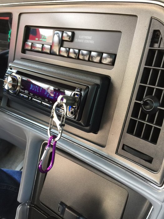

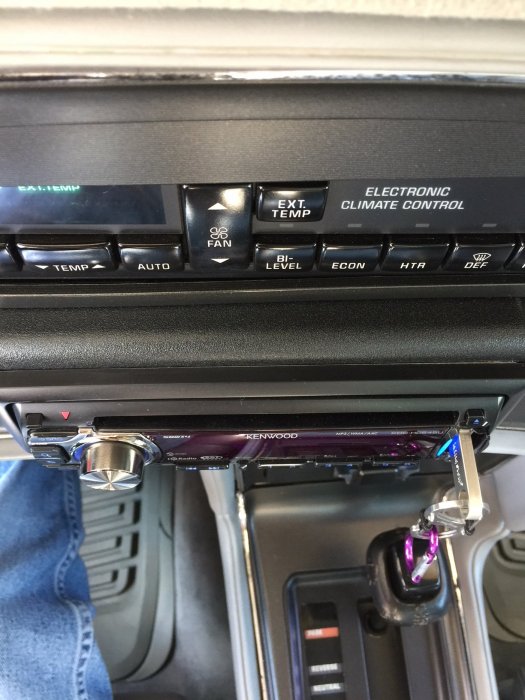

Frogware Posted October 12, 2017 Share Posted October 12, 2017 Frogware, Long way of saying that I am interested in the photos that you offered to post . . . and your opinion and the opinions of others as to how to best set up the '90/'91 Reatta interior to incorporate the modern phone. Thanks in advance for the help!! Nittany, Here are both applications; The first one I removed the factory radio/cd player and used a GM install kit. Front view Link to comment Share on other sites More sharing options...

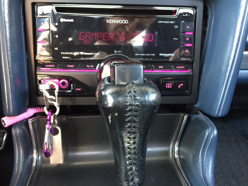

Frogware Posted October 12, 2017 Share Posted October 12, 2017 The next one I kept the factory stereo (No CD) and put a double DIN where the broken CD player was (Some Reatta's have a Garage in this spot) Front View Link to comment Share on other sites More sharing options...
