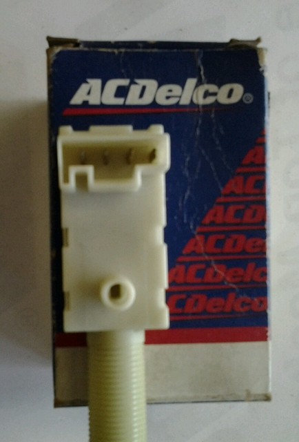

jglawnyc Posted July 31, 2017 Topic Author Share Posted July 31, 2017 TEST RESULTS ARE IN: I tested the advice of RetiredMechanic74 and to my amazement, it worked....sorta. I did 4 test runs on a small stretch of highway (the Belt Parkway) near my home and the first 2 times the cruise on my '91 coupe worked great! It responded well to the accelerate button, the resume cruise function, and the decelerate function. This all occurred after I put my foot up against the back of the brake pedal and just a tiny slight bit more than gently pulled it back towards me while I set the cruise button. She then behaved beautifully even after I had released the upward pressure on the brake. On the 3rd and 4th test.....nuthin! I gave the brake a little more reverse pressure than before, then a little less, I held it up, I released it quickly....all with no effect. I'm assuming the vacuum lines are fine since it did work and that I should be focusing on the brake pedal switch adjustment or replacement. Do all concur? If I haven't said it before, thanks so much for all the help Ronnie and all the wonderful community of car lovers we have here! Link to comment Share on other sites More sharing options...
Ronnie Posted July 31, 2017 Share Posted July 31, 2017 ...I'm assuming the vacuum lines are fine since it did work and that I should be focusing on the brake pedal switch adjustment or replacement. Do all concur? If I haven't said it before, thanks so much for all the help Ronnie and all the wonderful community of car lovers we have here! I don't think you should just "assume" the vacuum lines are good. If it were me I would check them closely to rule them out as being defective... BUT, I agree that the switch could be bad. My S10 Blazer would randomly kick out the cruise and the problem ended up being the brake light switch. If I were you I would replace it to see if it fixes the problem. I'm glad you like this website and find it helpful. I appreciate all the members here who have offered to much help to keep our Reatta on the road. ;) Link to comment Share on other sites More sharing options...
jglawnyc Posted July 31, 2017 Topic Author Share Posted July 31, 2017 Hi Ronnie: Is this what you suggested? http://thereattastore.com/standard-motor-products-stoplight-switch/ Link to comment Share on other sites More sharing options...
Ronnie Posted July 31, 2017 Share Posted July 31, 2017 Yes, that switch should fit your 1991 Buick Reatta. You should be able to find it at your local parts store. Link to comment Share on other sites More sharing options...
