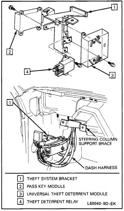

jglawnyc Posted June 7, 2017 Topic Author Share Posted June 7, 2017 Thanks so much again guys. Armed with the advice and photos/diagrams, I contorted myself back under the dash to pull the relay and head to autozone......and couldn't find anything. I knew it wouldn't be easy but geez, it's a complicated mess under there, and nothing looks like shown in he diagrams. It was at this point that I realized that droid was referring to the theft deterrent relay, and Ronnie the starter interrupt relay, neither of which I could locate after an hour of trying. Your assistance is greatly appreciated. Bypass scheduled for next weeK. Link to comment Share on other sites More sharing options...
Ronnie Posted June 7, 2017 Share Posted June 7, 2017 It's possible the relays could be in a different location on your '91. Let me see if I can find any information that might tell. Link to comment Share on other sites More sharing options...
Ronnie Posted June 7, 2017 Share Posted June 7, 2017 It appears the theft deterrent system in the '91 is in about the same location under the dash but it is different than the earlier models. Perhaps the photos below will help you. http://reattaowner.com/forum/attachment.php?aid=511[/img] Link to comment Share on other sites More sharing options...
