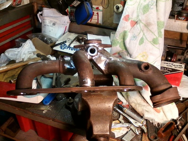

Aztec62 Posted May 19, 2017 Share Posted May 19, 2017 Wow, looks like a lot of work! What do you think how much horse pwer will you gain with this modification? Henning Link to comment Share on other sites More sharing options...

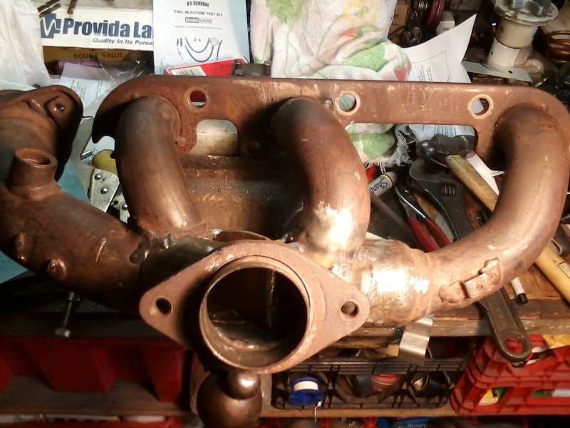

2seater Posted May 19, 2017 Topic Author Share Posted May 19, 2017 Hard to say if it will be worth anything? I imagine it might sound a bit different, but primarily, this is just to satisfy my curiosity. It is a fair amount of cutting, fitting and welding, but easier than the turbo manifolds and piping I have fabricated. It may get used with my low yield turbo setup that is powered by the front cylinders, or would work N/A too. It looks pretty bad right now but ultimately it will be ceramic coated titanium gray with no heat shields. Link to comment Share on other sites More sharing options...

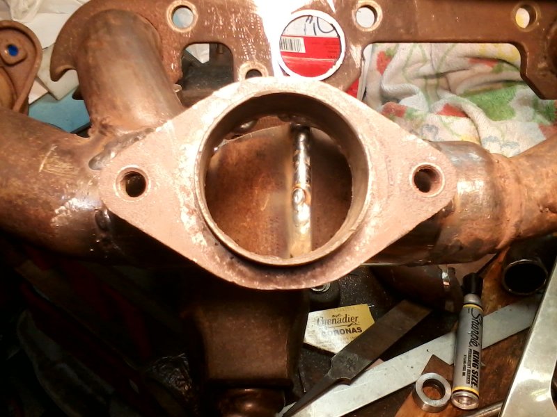

2seater Posted May 20, 2017 Topic Author Share Posted May 20, 2017 Maybe this partially cleaned up view will make more sense. While it will never be elegant, it will be conveniently located out of sight ? Link to comment Share on other sites More sharing options...

Ronnie Posted May 23, 2017 Share Posted May 23, 2017 It appears you have added another location for an O2 sensor. Will you be running two or plugging the old one? Link to comment Share on other sites More sharing options...
2seater Posted May 23, 2017 Topic Author Share Posted May 23, 2017 I know that's what it looks like but it is the port for the EGR and is untouched. The stock O2 port was removed and relocated slightly as close to the exhaust stream merge as possible. It could be more streamlined, but not much without reconfiguring the #2 and #6 runners. As it is, the #4 was moved out 1/2" from the flange tilted and re-angled to point more to the outlet. Link to comment Share on other sites More sharing options...

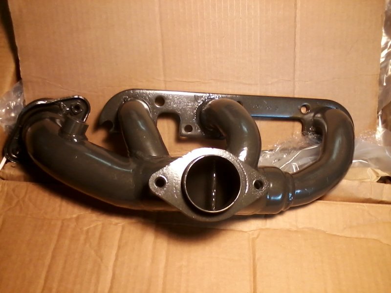

2seater Posted October 2, 2017 Topic Author Share Posted October 2, 2017 I finally got around to sending the manifold out for coating and it arrived over the weekend. The color is darker than I thought it was going to be but the quality is very good. Link to comment Share on other sites More sharing options...
