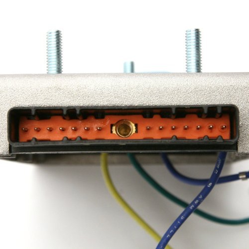

Ronnie Posted May 5, 2017 Share Posted May 5, 2017 Everything you need to know to change to the ACDelco ignition system is pretty much covered HERE. Thanks to Padgett for providing the information. Here is what the connector on the ACDelco ICM should look like if you go to a salvage yard to get one. I printed the photo below and took it with me to make sure I got the correct one. Link to comment Share on other sites More sharing options...
