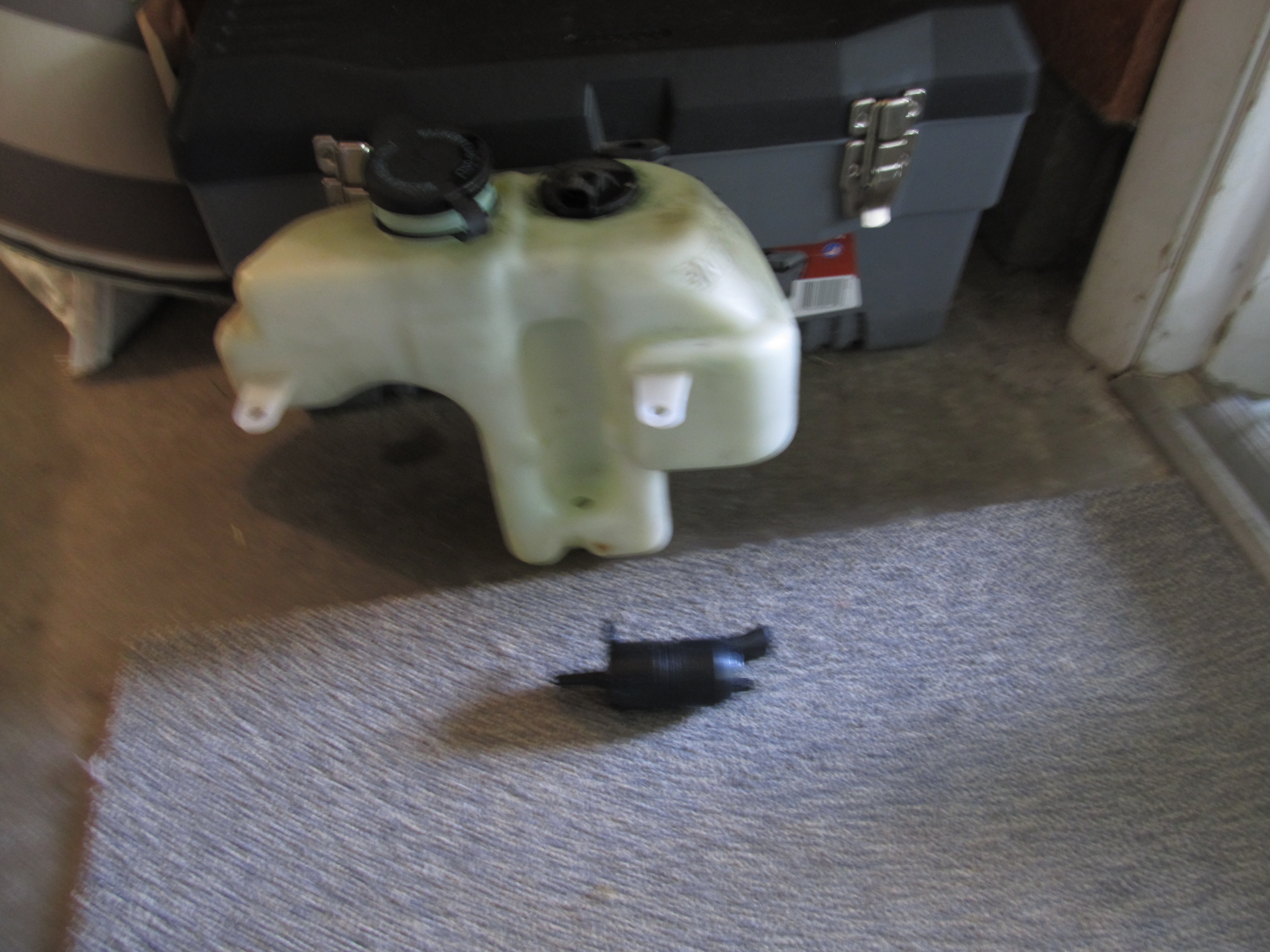

tomsbuick Posted May 3, 2017 Topic Author Share Posted May 3, 2017 Link to comment Share on other sites More sharing options...
