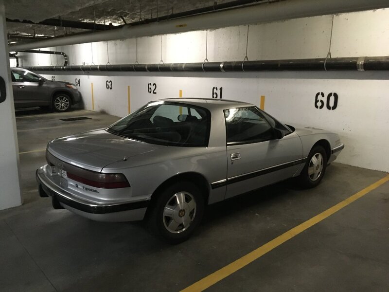

DH Comet Posted February 6 Share Posted February 6 My silver '88 lives in an underground parking garage - a friend's second space, which she doesn't need. It's an informal agreement; the strata council there thinks the car is hers. It's great having the car under cover, but there is no power down there at all and if I leave the car for two or three weeks without driving it (easy to do, this time of year), the battery will go dead. I've tried using a battery disconnect, which worked well for the battery, but I started to have issues with the car, mainly in the climate control area - heater doors would stop working, etc. I think they didn't like being plugged/unplugged all the time, and my regular mechanic recommended against the practice. There is a fluorescent bulb overhead, and I have a solar trickle charger that puts out 12.5v from the light of the bulb alone, but that's an unloaded reading and I suspect that it doesn't really do much. Any ideas? It's gotten so that I'm considering selling the car - I can't keep putting batteries into it. Link to comment Share on other sites More sharing options...
