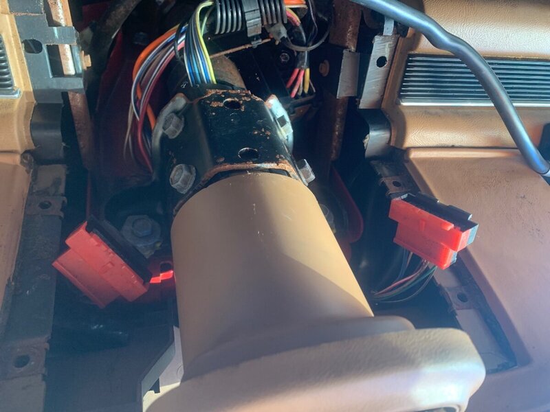

So I took the cover off from under the steering wheel and found the two female pin connectors for the ipc. I haven’t found in the manual where the solar cell contacts this line cause I’m assuming that comes before the pin connector's. Anyone know what section of the manual I should take a look?

If you mean the photocell that measures daylight, that's on top of the dashboard. It doesn't blank out the IPC completely, just dims it.

I don't think you are going to find a wire in the IPC connector that comes from the photocell. The wire from the photocell goes to the BCM. The BCM controls the brightness of the IPC and CRT based on inputs it gets from the photocell and the dimmer slider on the headlight switch.
You haven't mentioned the CRT. If the CRT is working properly the photocell isn't likely to be your problem.

Yeah you’re right my crt is indeed working, so could it be the actual ipc. I mean it does have some burn marks inside the glass but I just thought they were from soldering .
Odds are good that your IPC is bad.
Check these pins:
LTE B+
RTG gnd
RTH 7V
RBA B+
RBB B+
RBC gnd
RTD gnd
All tests to be performed with ignition in Run
