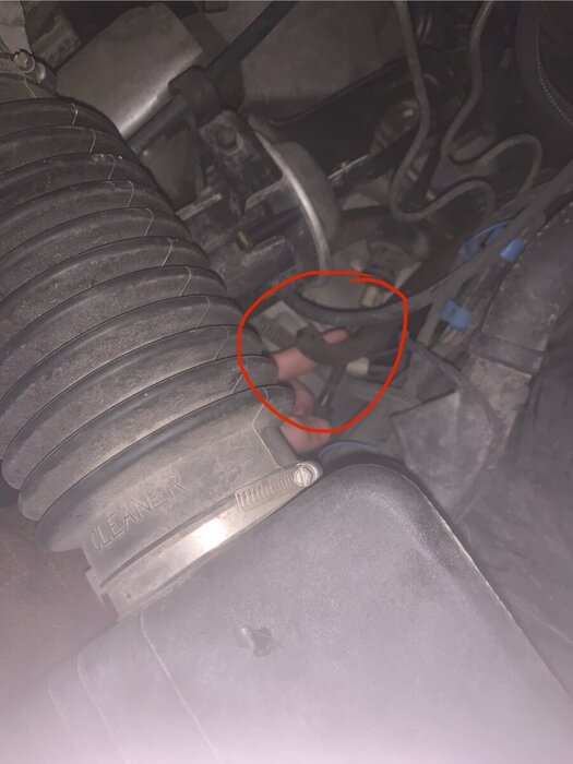

Just got off work and the car won’t start. No noise at all when I turn the key. Headlights turn on and battery voltage reads at 12.1. Service engine soon light is on when the key is turned but there’s no engine codes.
I looked under the hood and found a broken line/hose. I’m not sure what this part is or if it’s the problem.
Seems like the no start issue’d be a bad starter or fuse/relay. Any advise? And what is this in the picture

That's the large diameter cruise hose.
If I was a betting man I would say either crank sensor …
Hey Dave, thanks for the reply.
What does the cruise hose connect to?
